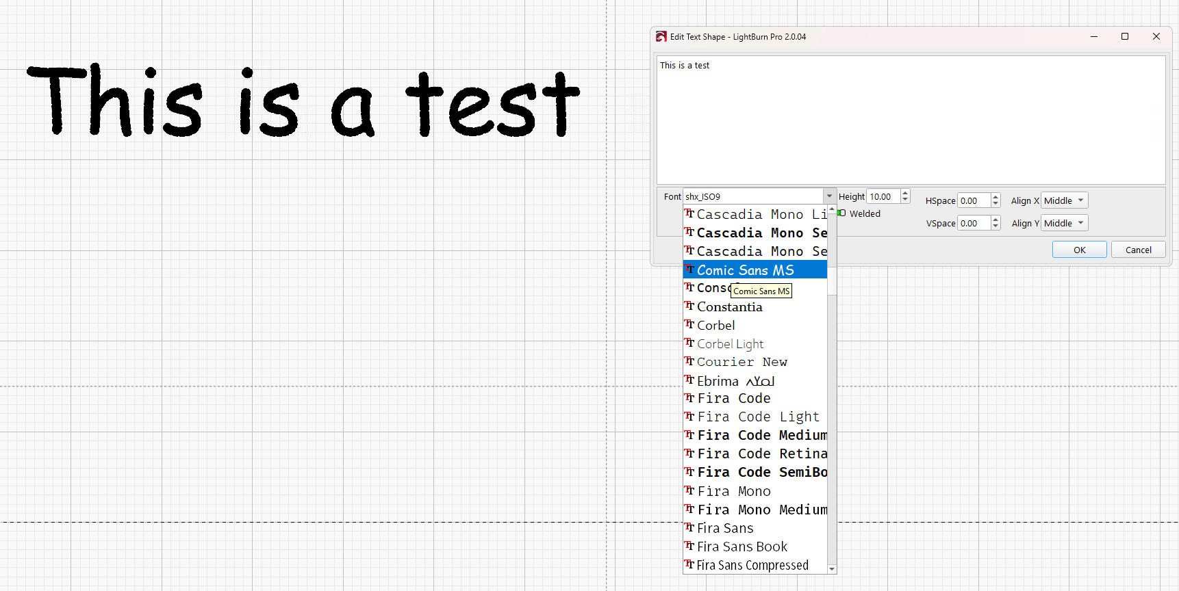

Double-clicking on the text opens the Text Editor window, clicking the font dropdown opens a list of all the fonts, and the highlighted font is applied to the text:
That isn’t quite All The Fonts At Once, but scrolling down through the list is a quick way to check them out.
