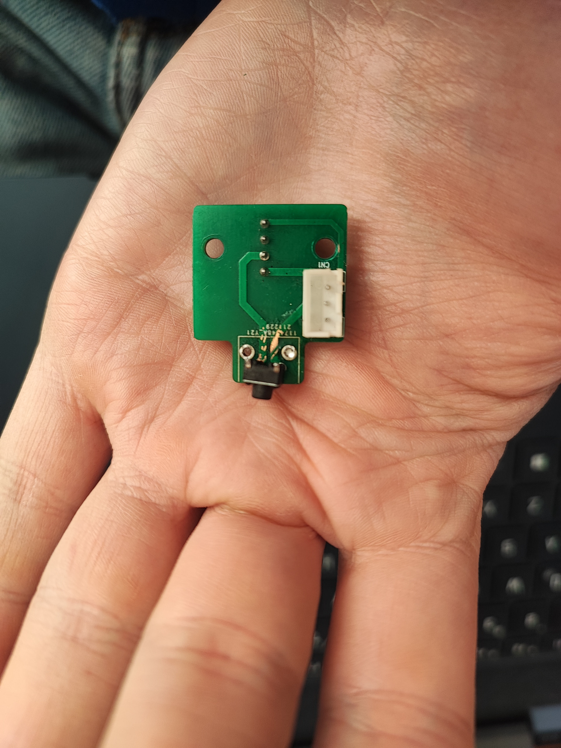

Hello everyone!
I just received my brothers old laser engraver. After taking it apart i realized the limit switch is broken. I have tried finding a replacement but i can not find it.
Do you guys have some site where you find replacement parts ?
Sorry if this is not the correct place for this post.
If you’re looking to replace just the switch, one plucked from an assortment like this will work:
https://www.amazon.com/dp/B0858XRGYW?th=1
Because it’s obvious the PCB was designed for a different switch with a frame soldered into those two big holes, I’d fire up the hot melt glue gun and anchor the new switch firmly in place, so the pins & solder aren’t absorbing the mechanical stress.
Perhaps one of these will fit those holes:
The actuator button looks longer, but judicious application of a flush cutter should fix that; you’ll have plenty of spares for practice.
The PCB looks unique, so you’re unlikely to get one except from the OEM.
That makes a lot o sense, thank you for the help !
