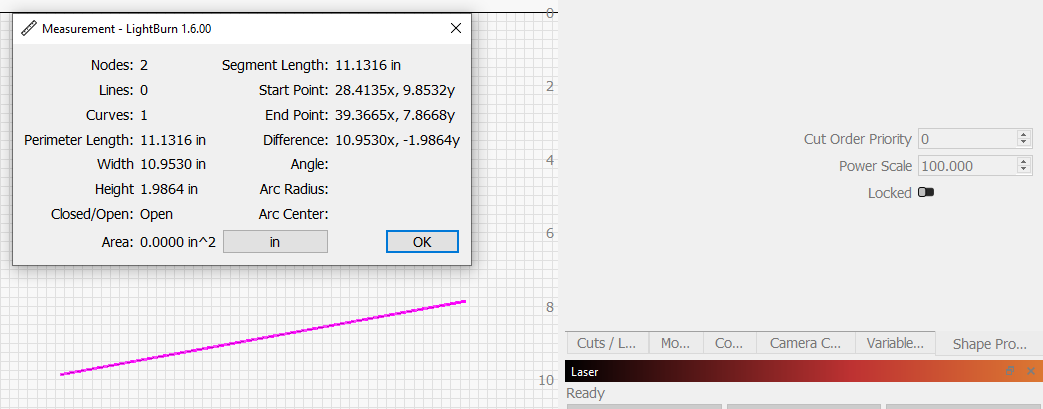

I would like to find what degree this line I drew is. I would also like to align it horizontally.
Shape properties and measurement give no angle information.
If I grab and try to rotate it I only get degrees of rotation from 0deg.
If I go to node edit and try and align with A it is not aligning.
What am I missing here?

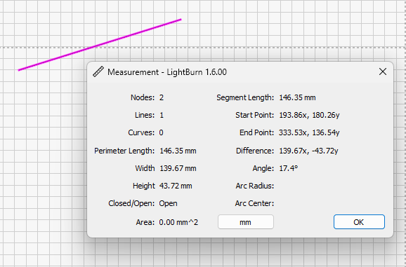

I would say that is because this is a curve and not a straight line.
Here’s what you see if it’s a line:
Ah thanks. It looks straight but when I pressed L in node edit things started working.
In terms of strategies for aligning it horizontally:
- push A while in Edit Nodes and hovering over the line
- create a known square and horizontal line/shape at the lowest corner of the line. Then use 2-point rotate/scale to rotate the rest of the shape against the reference horizontal line
