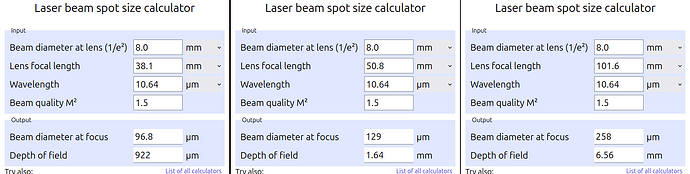

You should consider depth of focus (dof) and spot size. There are on-line calculators to give you a good estimate of what you can do with a lens.
I got most of this data from the tubes manufacturer, but it can be had in other ways. I don’t know how you’d measure beam quality ( M²) without a rather expensive machine. These are three screenshots of the calculator I use. The difference on the input is only lens length. Note the output.
Generally when cutting thicker materials you want a lens that will maintain the spot size throughout the area you need to engrave/cut. Left is a compound lens, making the smallest spot size of 968 microns (0.968mm), however it’s dof is only 922 microns, or less than 1mm.
You can pick the highest possible dof or the smallest spot, but they go opposite ways. Can’t have a small spot with a long lens.
With a 2" (50.8mm) I get a spot size of about 129 microns but a dof of over 1.5mm. I use my 7" (101.6mm) for cutting thicker material, such as 5mm sub flooring, as it has a 6.5mm dof. You have to focus at the midpoint of the material to use the entire dof. If you measure to top of material 1/2 of your dof is lost or wasted.

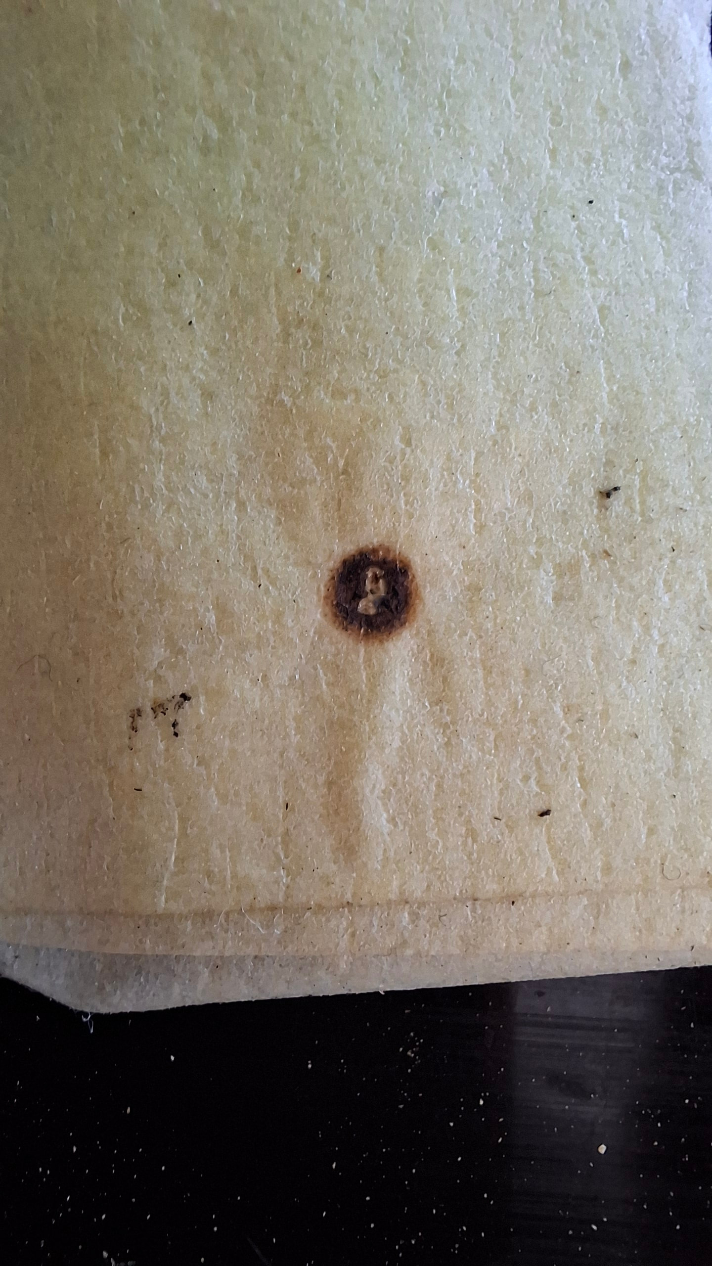

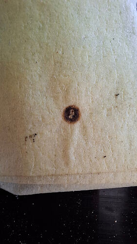

can you show a test shot on m1, it should be a nice round filled brown dot of approx. 6mm.

Here it is, the stop on the M1 straight from the tube, actually I did not expect to be good as it is.
We’ve definitely seen worse! :grin:
Set the controller for a shorter manual pulse to reduce charring in the center part of the spot and fire it at white paper with less texture. If the spot has a uniformly dark center tapering off smoothly to the edges, then the tube is likely working fine.
If that’s the case, then spend as much as you’d like on fancy lenses & mirrors, keeping in mind they won’t make as much difference as you’d like.
