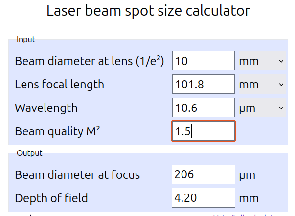

My 4" has a dof of ~4.2mm. I use it to cut 10mm acrylic. Can’t really see a change that causes a sloping cut.
I use this online calculator.
Some items must come from elsewhere as it’s different value. These are what I’ve setup.
