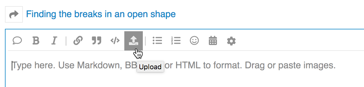

Thanks, Rick - Selected all the image and clicked the Auto-Join button, and achieved partial success, but 2 open shapes remain, and I’ve checked every point for proper joins (I hope) and it all looks ok, but review still insists there are two open shapes…I can’t see anywhere here to attach the file, so I might go back to the email, and attach it to a reply there…
cheers
Peter
Hit this to upload:
