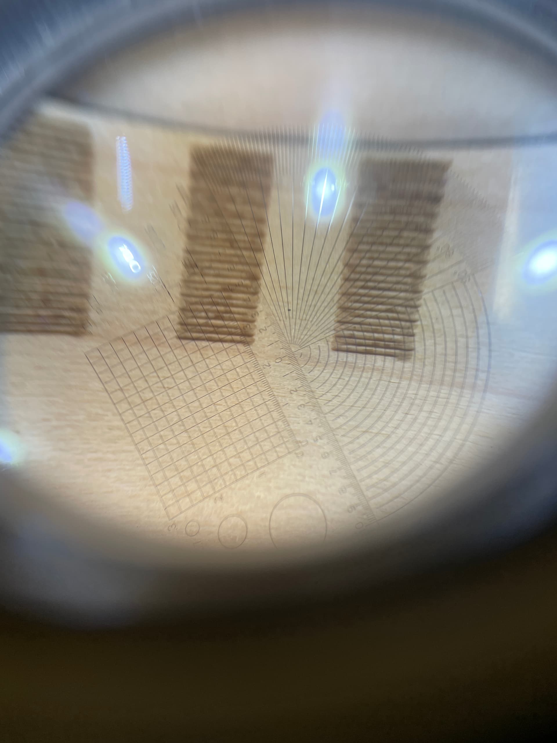

I noticed recently when performing a scanning offset test, that at the start of each line, the engraving is fuzzy. It’s always thicker and lighter than the rest of the line. Below is a picture showing what I mean. This is on plywood. Sorry for the poor quality, the picture was taken through a loupe.
You can make it out best at the bottom right.

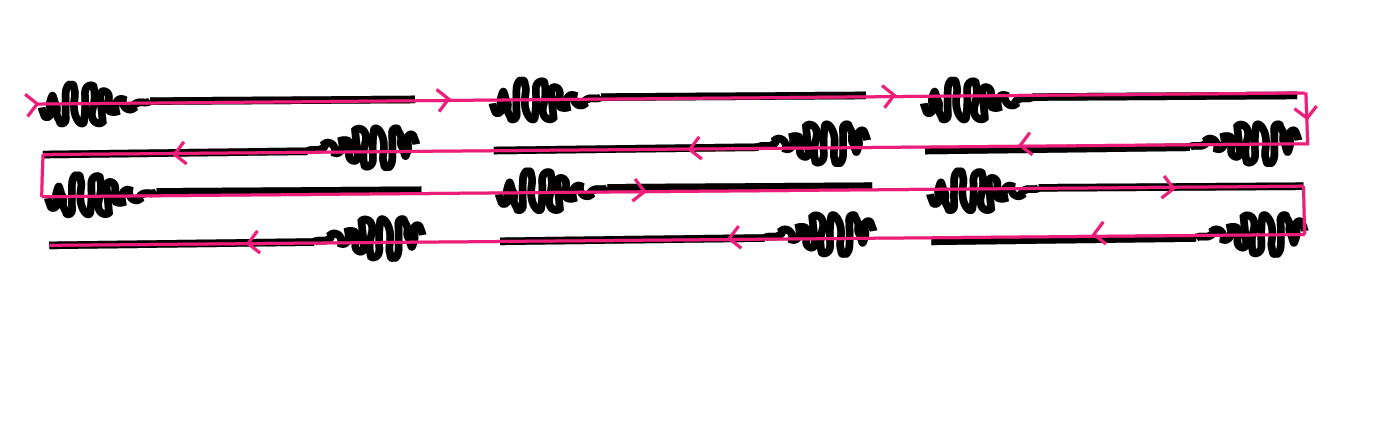

This isn’t an issue having to do with the line shift speed. If I have it engrave 3 separate sections at once it happens at the start of each engrave line. It’s not just happening on the ends where it shifted. I made a drawing showing what is happening (obviously exaggerated) and the red line shows the path of the laser head.
It’s always at the very start of the line, no matter which direction it’s moving along the x axis. It’s as though the firing of the laser is somehow causing this.
Could it be laser pre-ignition %? I moved it up a small amount from 1% to 2 and 3% and didn’t see any improvement. But I could go more, if that’s recommended.
Or maybe it’s because the wood isn’t hot enough at the start and the heat is being dispersed?? If so, how do I counteract this?

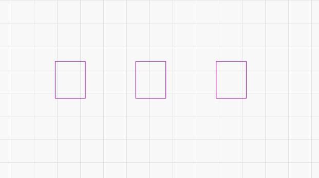

It’s not happening in the middle of a line. I have my scan offset test set up where there are 3 separate blocks next to each other, the image below is what the file would look like. This way I can see the difference of the offsets from when the line is starting, at full speed and when it is ending. And at the start of each engraving is where the issue occurs. If you do this yourself, you’ll probably see a slight variation in the scanning offsets between the different phases of the engraving.

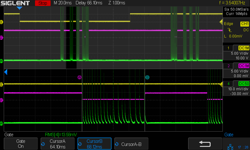

That seems due to the tube ignition delay, which isn’t particularly well controlled and is affected by its recent activity. A 60 W tube at 24% is running near the low end of its firing, so the startup will be even more erratic.
The green trace in this oscilloscope shot shows the tube current at 10 mA/div with power at 20%:
That’s from a post I made a while back while measuring RMS tube current; it has scope shots with other power levels.
Obviously, the tube doesn’t simply light up at the start of the pulse and fire continuously until the end.
A coarse-grained material like wood makes exact measurements difficult. If you have some white cardboard lying around, photos of that will make small features easier to see.

I’m confused then, why did the problem get almost completely fixed?..There is one other thing I did, but I can’t remember at what point I did it. I bought this dampening stuff called Sorbothane and put it on mirror 1’s mount. It always seems to be vibrating at a high frequency. If I gently touch my finger to the piece that holds the mirror, I can feel it vibrating. Of course, the way those are designed with the long skinny pole supporting the piece that holds the mirror, something like that is always going to vibrate. It’s almost a tuning fork.
Maybe adding that sorbothane fixed it. But what was making it vibrate at the start of the middle block of engraving? Maybe the RMS pulse like you mentioned. I’m not really following what’s taking place with that though. I understand it’s less stable as it first fires, but what is the oscilloscope showing? I went to your page describing it. I may have to read it again. Or another 5 times.
