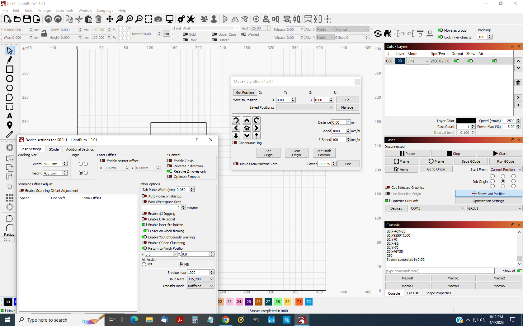

Can you provide the following:
  1. Full screenshot of LightBurn with design loaded and with Move window and Laser window showing.
  2. Do File->Save Gcode and save to a file with .txt extension and upload file here
box2a.txt (269 Bytes)
Very odd indeed.
Everything looks fine from what I can see. There’s nothing I can think of that should prevent this from working but LightBurn is choosing to not specify a non-zero power level.

I’m suspecting something more fundamental. Can you try reinstalling LightBurn. You can simply install on top of your current installation. No need to change the Prefs file or anything. Just install and retest.
When you do the frame, are you first turning on the laser by pushing the Fire button? If so, can you try framing without doing that and see if it works?
Reinstalling lightburn had no effect. I did the framing with the fire button off and still not firing. Also I tried it with the fire button on and a beam showing, when I clicked “frame” the beam turns off an them the laser head moves.
Everything is working as I’d expect except for the S value when framing. I don’t think I’ve seen this before and can’t imagine what would cause this…
@Rick @Colin @JohnJohn jump in here in case I’m missing something.
I asked the manufacture if they had any thoughts, and they had me enable DTR in the settings. When I enabled it, the laser still didn’t fire with framing, but if I click the fire button in the move window and then click frame, the beam goes off and then turns back on when the framing begins and back to off when finished. Maybe this is a clue??
I didn’t think DTR would in any way change the code being generated.
Can you capture the Console output with DTR enabled and with fire button turned on before framing?
