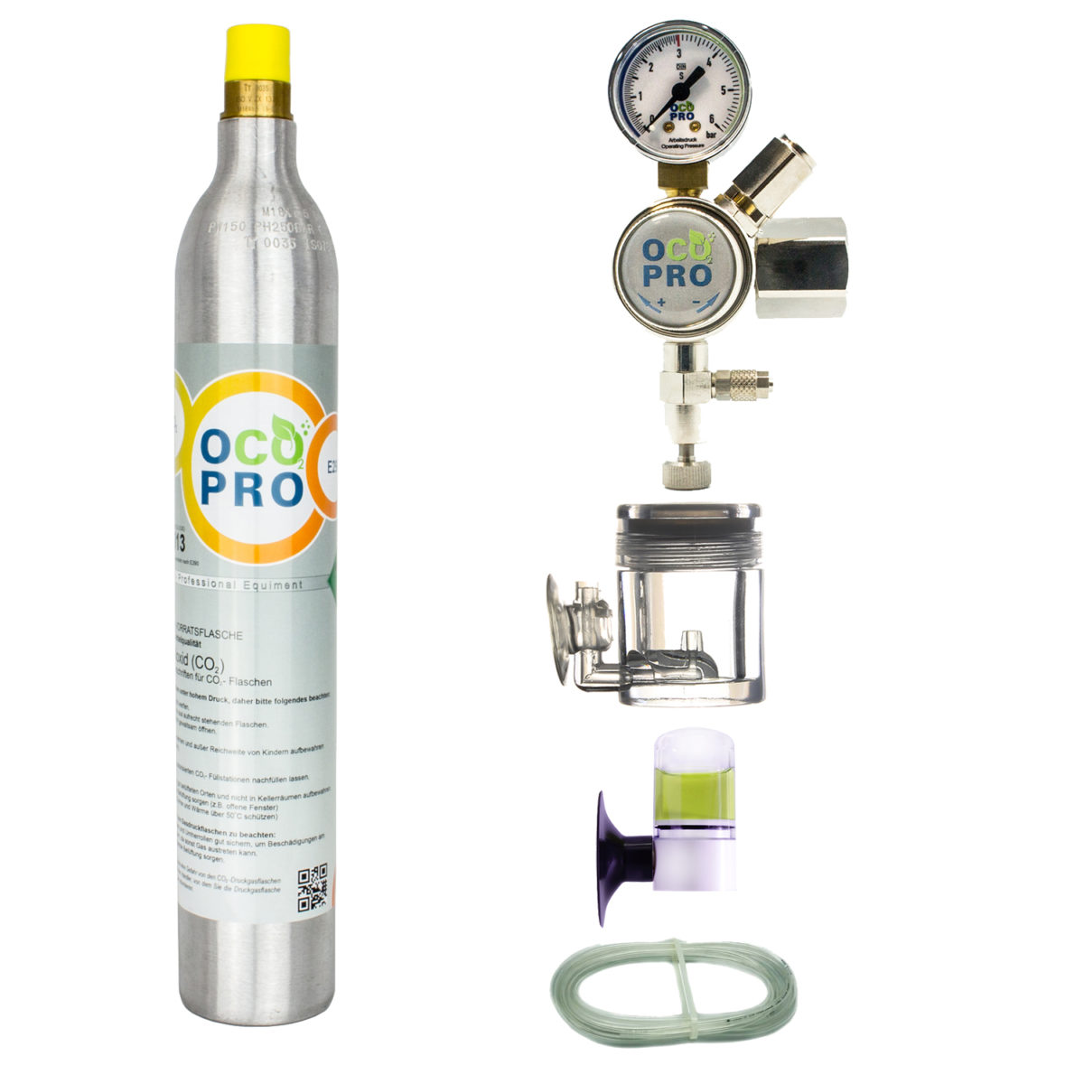

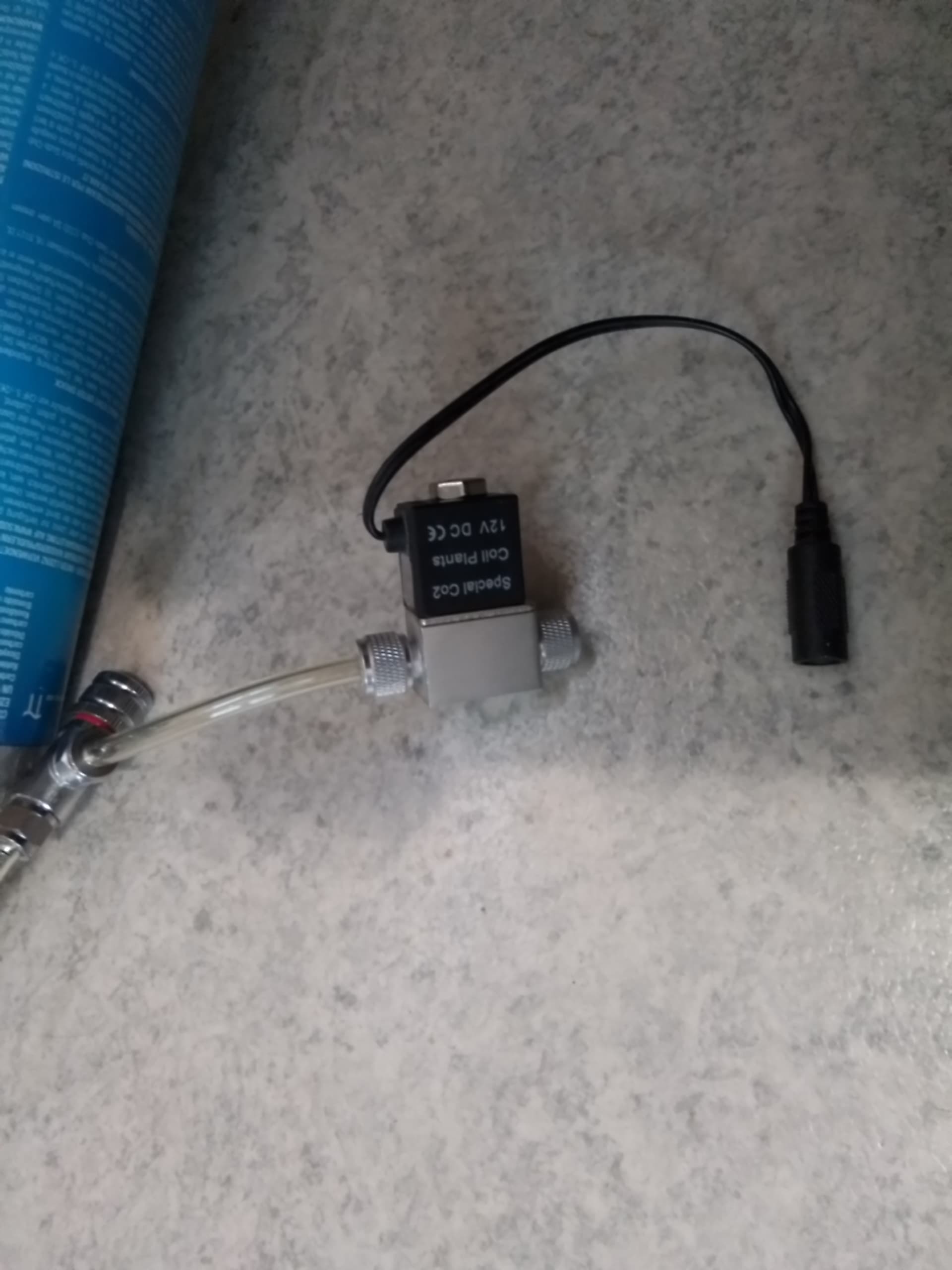

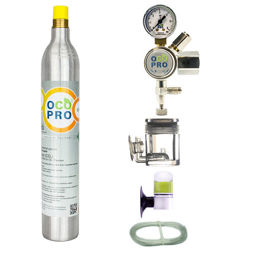

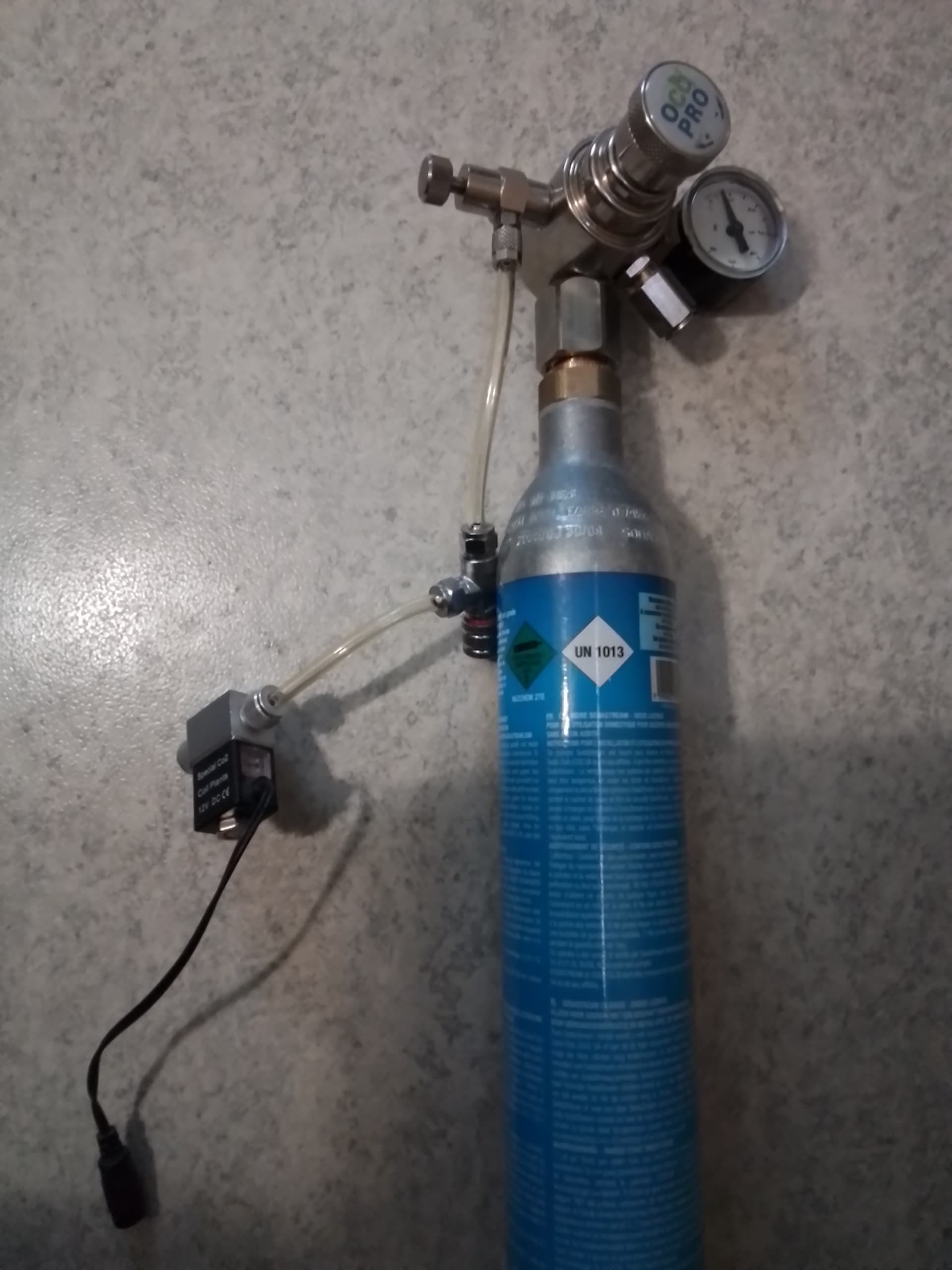

I have a comparable system from my aquarium with a SodaStream or compatible cartridge, a precision regulator and a 12V solenoid valve, so it can be controlled by the motherboard, or with a cell connected in series to the fire light, as the light flashes, it diffuses CO2 to me in fits and starts, it works wonderfully, choose a tube that is resistant to CO2, another system that I tested is a 12V mini peristatic pump, it costs 3 euros on the net, the problem is that it wets. Donât believe everything you hear about fire extinguishers, here itâs a question of extinguishing with the laser beam from the start, not a house fire, for that you need real fire extinguishers (with verified date) and the firefighters! A brand sells a system at a high price and itâs just a mini water pump! I much prefer the Co2 system which deprives the fire of oxygen, itâs clean, dry and efficient, only the pressure extinguishes the flame! BUT THE BEST IS TO ALWAYS BE NEXT TO THE MACHINE, USE A CAISOâ ADAPTER IS ALSO A GOOD THING!
