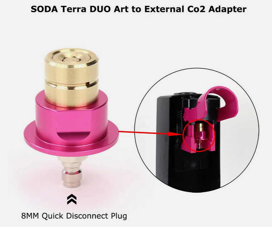

A printed adapter would appear weak to me…
Why not using a Sodastream conversion adapter (fish tank, paintball, …) and an electrovalve on the tube going to the laser head?

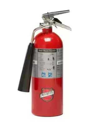

I have something like this from a restaurant supply company. It was the lowest cost place I could find… Same device, just lower cost.
Wherever machine I’m using, it’s within grab range.
It’s been a few years and the price was around $115 USD

Hi.
Based on what exactly?
Not trying to raise an argument, but genuinely curious as to why.
Granted, I don’t know enough (yet) about the cold strength properties of the various filaments (and/or resins) available for hobby 3D-printing, but as a BEng Mech, ATM I for one don’t see any problems using a 3D-printed properly designed handle.
This thread was about handheld fire extinguishers, not fixed ones.
Furthermore, if we move into fixed systems, the (cheapest possible compressed air?) solenoid valve would be a weak link, so a mechanical plunger to actuate the bottle valve itself would be a much better choice.
If one want’s to use such a solenoid valve, it needs to be a CO2 valve, for the intended flow rate or larger.
Much, MUCH easier and cheaper to fashion a tandem solenoid valve block or a parallel mechanical bypass valve, small adjustable flowrate for air assist, large flowrate for fire extinguishing.
It’s pretty much impossible to build a reliable fire extinguishing system (on a tight or no budget) that consists of a compressed gas container with a press-to-activate valve, a regulator that has some means to press the valve on the container (a screw actuator on those links), and an electrical valve to let the gas go forward, to somewhere.
The operator would need to remember to arm the system every time before they use it, and disarm it when they finish using it.
Works very well with vehicles, welding equipment, sodamakers, paintball guns, -mortars, -cannons, -etc., a terrible idea as a fire extinguisher design.
IMO anyway.
