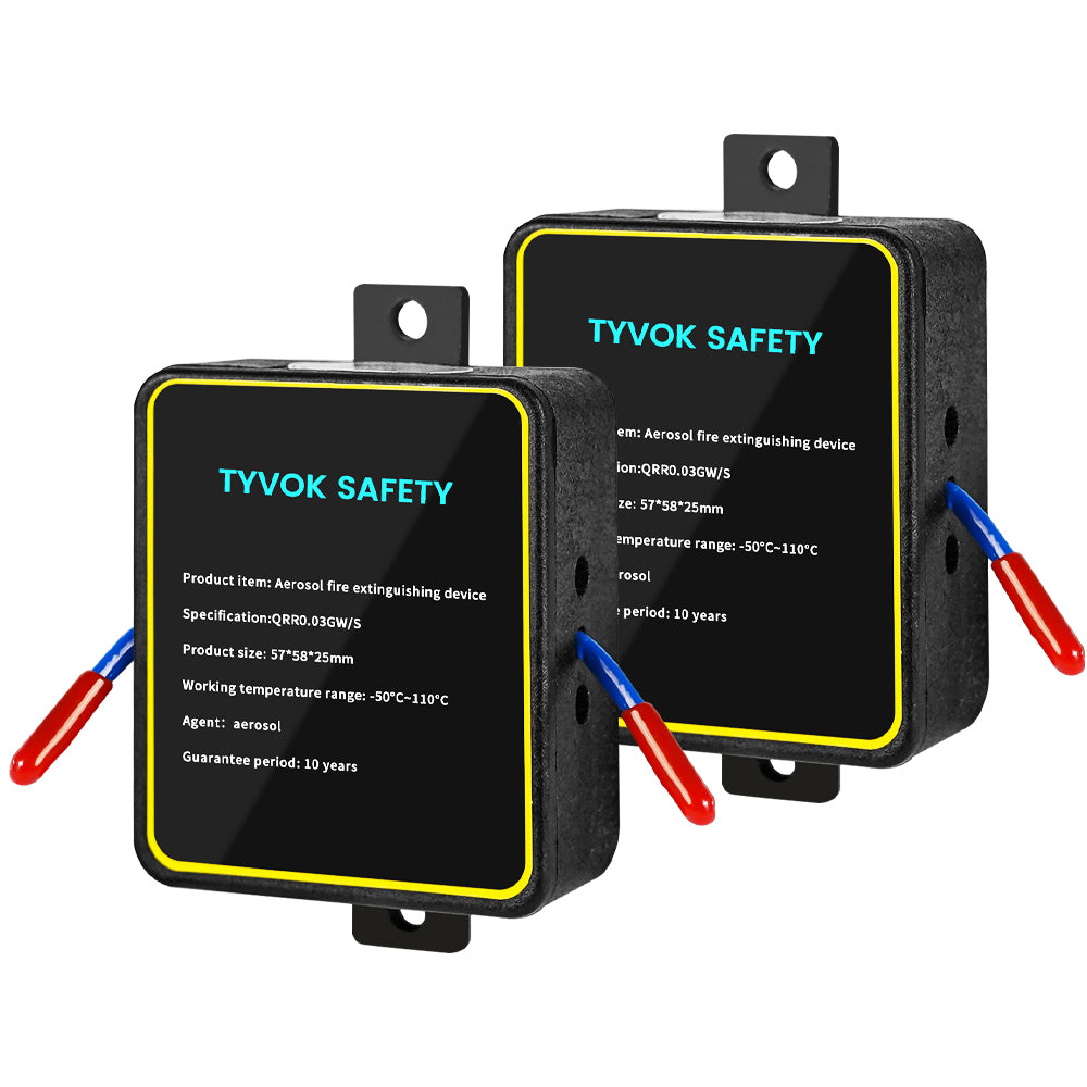

Its the system used on the Tyvok S1 which is viewable on ytube and priced around $46 for two and they are placed on the gantry and elsewhere. I think they recommend having around six of them.
Just paste it into the Reply. You cannot upload a shortcut.
Tyvok - Mini Fire Extinguisher(2-Pack)
€42,95
Something similar is sold by Amazon [US] as ’ Automatic Fire Extinguisher-Car Fire Extinguisher-’ for $30. It sez no residue which is good. Gene
