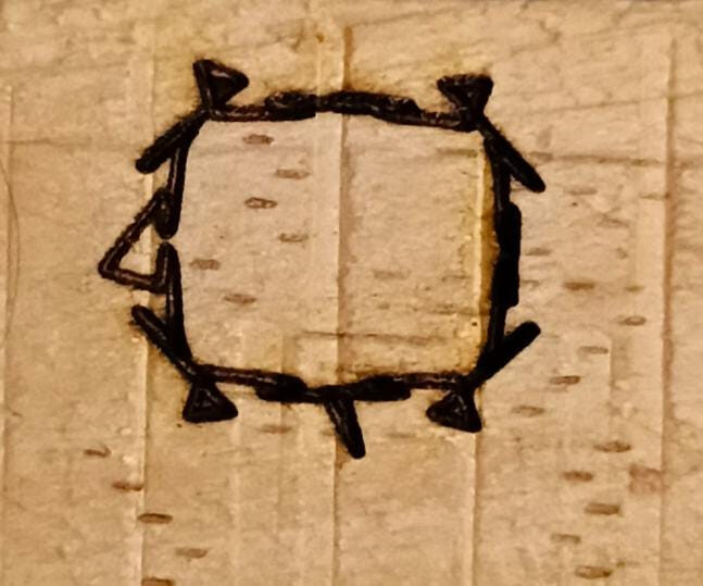

Also for unknown reasons, it is drawing strange things… This was supposed to be circle but came out as a strange thing.
That’s typically the symptom of a “cracked” LightBurn file downloaded from somewhere other than the Official Site:
You should also consider running a good malware scan, because similar programs generally install a bunch of other stuff you really don’t want on your PC.

Thanks for the guidance. You were right. Circle issue has been solved. Had used an old installer that I found online in a package of software for another engraver while searching for software for JL1. There definitely was something not right about it. I bought my JL1 engraver in used condition from a guy and naturally came it without any pen drive etc.
Upgraded to the latest version from your provided link and it is working like a charm. Will definitely get a license, once I get the hang of this engraver and make up my mind that whether I am going to continue with this new hobby or not. At the moment, I am bit too overwhelmed with everything. Thank you so much for sorting out the things for me. Really obliged.
