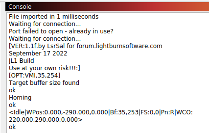

Loaded the firmware and found the X limit was about 3mm from making. Cut a spacer and put it in…
The axes were running backwards, had to change the config…

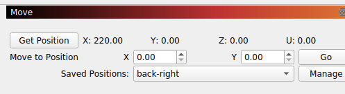

It is homing, but the home location y is in the negative numbers… Y seems to be a -290.

Is your offsets still persists?
Please post your “$#”?
If offsets still there - please reset all to zeros.
When you flash it, did you do Erase Whole Flash or only programmed space? Maybe try to erase whole chip first, then flash?

[G54:220.000,290.000,0.000]

Assume g54 needs to be zero?
Yes, correct, V2 firmware do not need any offset.
try full default reset:
“$RST=*”
then check again with $#

Looks good, number wise …
After the $H, the ‘move’ window shows ?
Screenshot from 2022-10-23 19-34-20
$# hasn’t changed…
Getting to be bed time for me :sleepy: … will be around tomorrow… thanks for the help.
Looks perfect to me. After hard homing it should stay at 220:0, bottom right corner. Unless you have setup $N to go somewhere else after homing, for example sending gantry back, to clear access for loading work piece. If you now command it to go to 0:0 (soft home) - it will move to the bottom left, and whole space is positive. (I see you have 0:0 saved as “back-right”, now 0:0 is front-left.)
