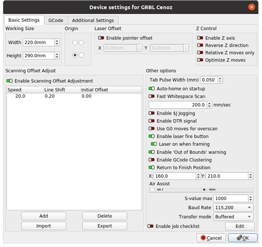

Homing
error:5
Homing cycle is not enabled in your Grbl settings.
Have not enabled homing, so that’s not a surprise.
Other than auto homing being wrong … this is the device settings…
It thinks it’s home, from manual position of head are in the negative numbers if I ask for it’s location.
Don’t know if the offset holds when it’s rebooted… ?
Thanks…
Jack,
This is alpha without properly working home cycle.
Start from flashing V2. You have STLink. I know it is a lot of labor to crack that extruded case open, just conquer it. Flash that V2 firmware.
With V2 you do not need to preserve offsets. They will be reset/erased, but you no longer need them.
Also please make sure your home switches are clicking nicely, especially if you have fat laser head that most likely will not allow to reach original Y home.
Then, as already mentioned, change speeds and accels to 3000 and 400. If you like. You may leave defaults 5000 and 1000 but then “wobble” may be noticeable on fine burn details.
I would expect all your oddities with JL1 will disappear after that.
Please complete above and report about whatever else is not working.
