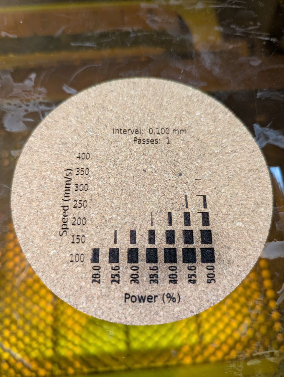

I just got a new Monport Mega Desktop CO2 with 70W and started my first experiments with cutting and engraving. Cutting looks good (will probably improve the air assist), but engraving isn’t working yet.

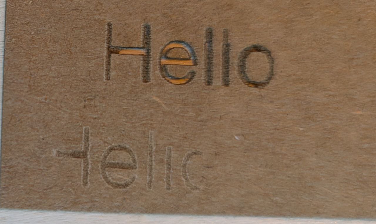

I did some quick experiements and found that the start and end of each engraving is missing (even with 10mm of Overscanning), very thing lines (<0.3mm) are not engraved at all and if I engrave a thin line with Bi-directional fill, it’s engraved twice with a distance of around 0.5mm.

In round numbers, the response time of the laser power supply is 1 ms. A 0.3 mm distance at 250 mm/s requires a 1.3 ms pulse, so whatever’s under the laser gets only a fraction of the intended energy.
That’s corrected with the Scanning Offset Adjustment over a wide variety of speeds.
Measure the actual kerf width and use that to compensate an entire layer or apply Offset Shapes to single objects.

Monport may have a .lbso “Scanning Offset Adjustment” file for you to import in the Device Settings. See, if you find such a file on an USB stick.

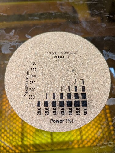

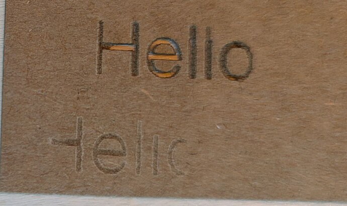

I ran the scanning offset calibration and it looks much better now! I’m having issues with the missing start and end line.
