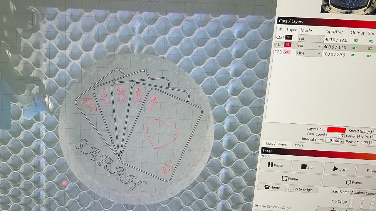

What the Engrave did. (The text is not the original as I could not get it to trace so I used the text in LightBurn, Is the speed too fast? The power could be lower, for sure. Speed 400/ Power 50, LPI 299.88 Line Interval 0.0847
Thunder Laser Bolt is the Laser I am using.
I just tried a coaster with an SVG file and it also messed up the text What am I doing wrong? Is the coaster moving on the bed? if so it is moving exactly the same amount each time it skips a line.

That is very weird how the laser head leaves the engrave and comes back. Are you using the start button or are you sending the file and starting the file from the bolt? I have heard, but not personally experienced that sometimes things get mixed up using the start button. Try it using send and start from bolt if you’re not already doing that.
Otherwise, more experienced people than me will have to jump in.
I used autofocus on the Thunder Laser Bolt, then find center of circle in LightBurn, then I set that to the origin, align my .SVG file, add text, and then hit send and then start both from LightBurn.
Does the preview show these movements? Enable show transversal moves, this will show where you head is supposed to be tracking.
Might want to slow down a bit from 400mm/s, it should work there, but we might not be able to see an issue that would be more pronounced, for human vision, at a lower speed…

So the issue definitely was using load and start on lightburn, once I used start on the machine everything worked perfect, Now I need to figure out how to resize the material test file to use on my coasters to dial in better settings.
This is likely a false negative. Using Send and then Start would be redundant but the end result should be no different than if you hit Start by itself since ultimately you’re ending with a Start command.
Did you by chance also delete any files on the controller while doing this? If your controller storage were full it could lead to odd behaviors. Clearing the storage could have affected the outcome.
Typically you’d either use Start or use Send followed by initiating the burn from the machine.
Hey Ed. I have 2 bolts and every once in a while mine does this as well (maybe happened 5 or 6 times in four months) and I always start my job by pressing start in Lightburn. I think the file gets corrupted or something somehow as it get sent via usb and the laser kinda freaks out (technical terms). Are you connected with USB or by ethernet?

I think you were misunderstanding how the start button in lightburn works. Using the start in lightburn is like streaming a movie, it sends info and the laser starts burning with a minimum amount of data and the rest of the data loads as it can. Using the send button is like downloading a movie, it sends the entire file to your machine then you choose the file and hit start on the machine. The entire file is loaded and nothing is streamed. Using the send then hitting start in lightburn is doing nothing for you, it is still streaming the data, not using the sent file.
Thank you for the clarification.
There’s a difference between GRBL and Ruida controllers.
GRBL controllers use streamed G-Code because they have a relatively small internal buffer. Old-school Arduino-based controllers have about 100 bytes / characters available and the protocol allows sending partial commands to keep the buffer topped off. More recent STM32 controllers have more storage and may be able to “stream” an entire program before the buffer fills up.
Ruida controllers require getting the entire program as a single binary lump and create a file in the controller’s flash memory. The Start button sends the program to a file called TEMPFILE, then runs that file. The Send button also sends the program, but to a file named after the original LightBurn file (chopped to 8 characters); you can then run that file from the controller console.

Correct, and he has a Ruida. GRBL doesn’t have a “send” option, only start or save GCode.
If I understand correctly from other sources, it will start running the TEMPFILE as soon as it has enough information to begin and the file continues to load, while running, until it is completely loaded. Which is what I think was causing his issue.
