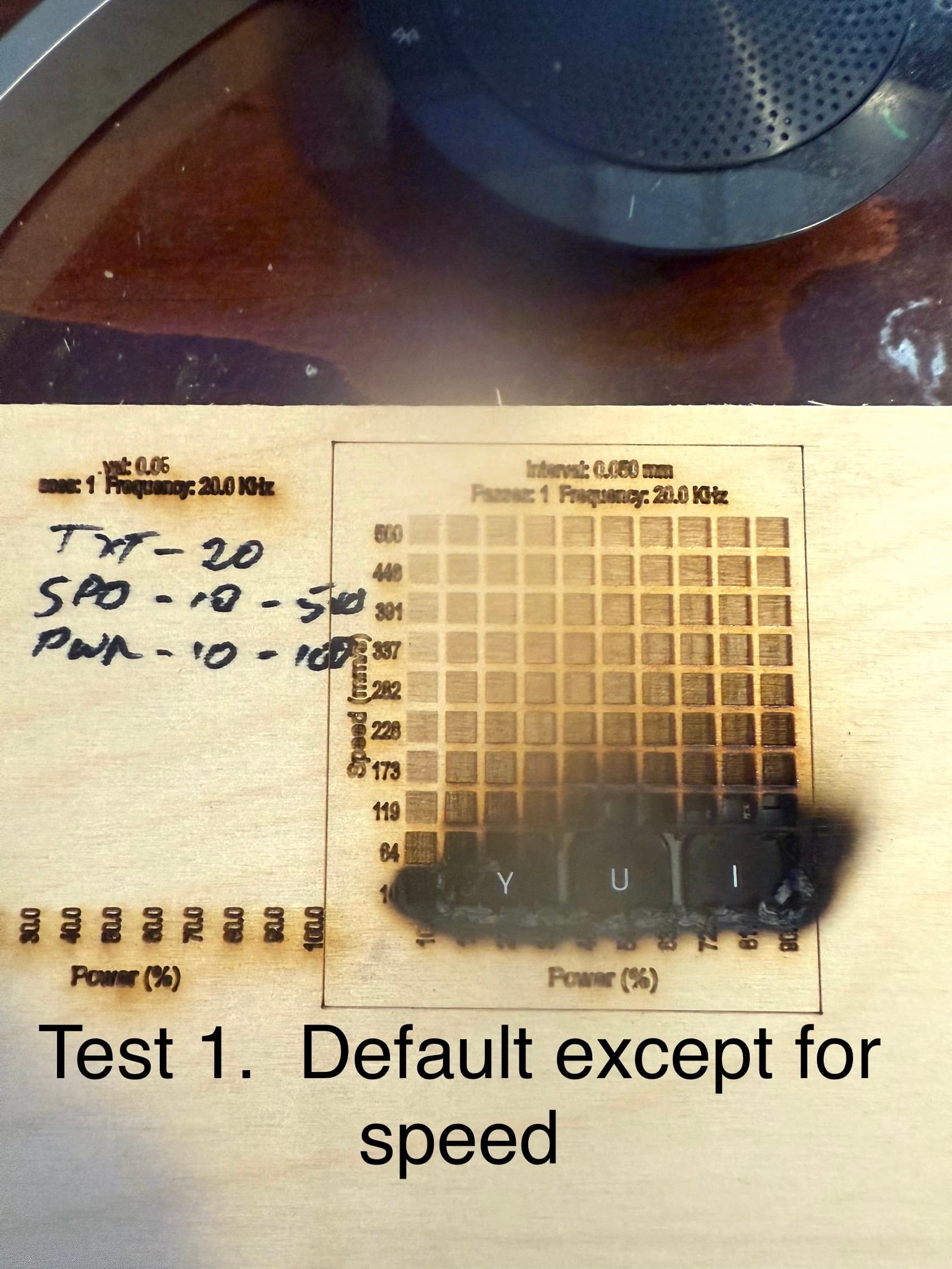

On Material test 1, Lightburn default, except I changed speed to 500. 3mm birchwood. Burnt the panel through, the bottom left at 100%. other than the obvious. See test pic.

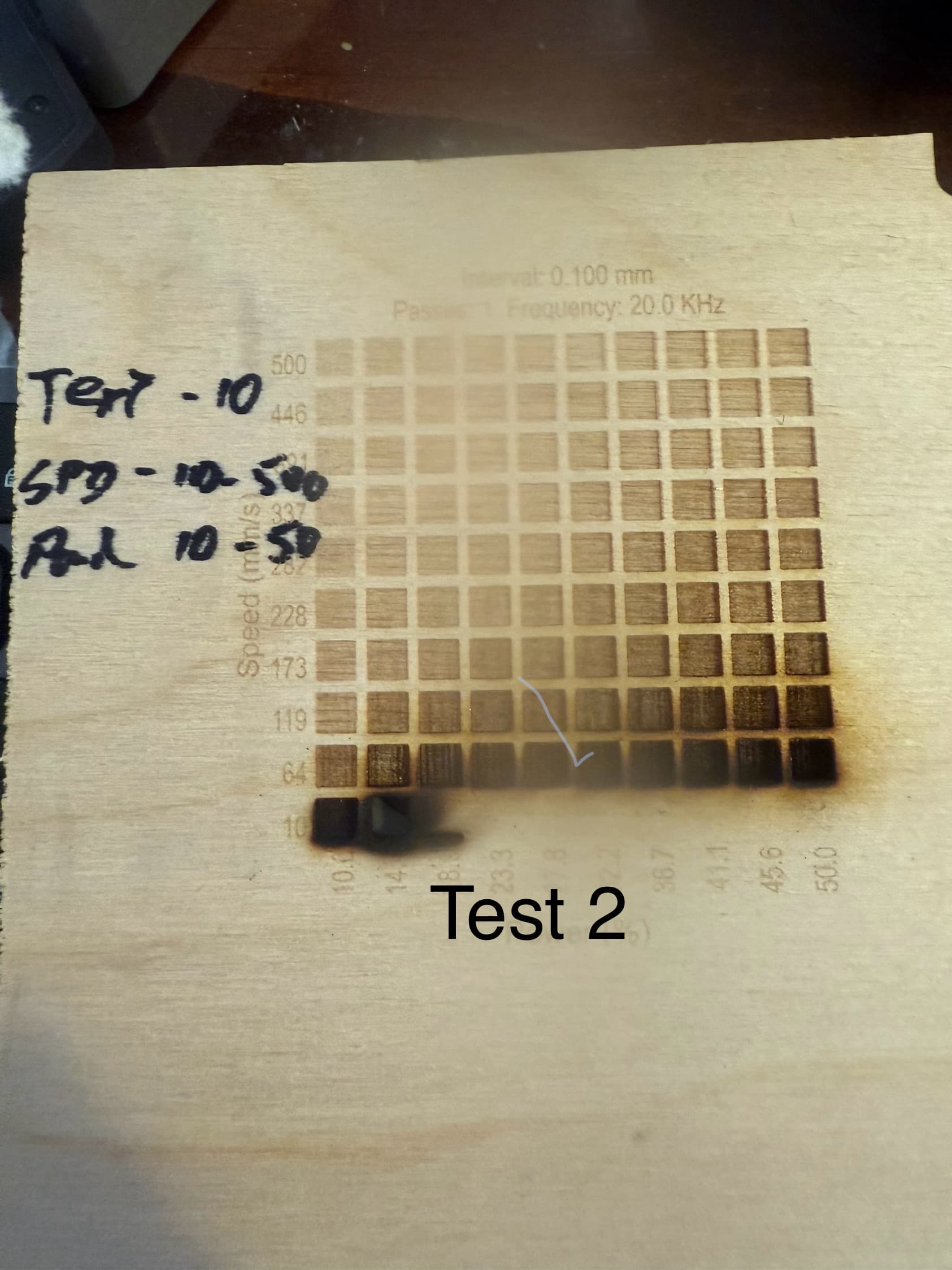

On material test 2 I cut settings in half, nearly the same burn issues in the same area. So the bottom left is power 50% though I stopped it before it burnt through. In both test it cuts deeper - through. See Pic 2
Help with settings where I can get get a near black shading, words without cutting to much into the wood. You see people making these gorgeous pictures, how? need help with settings and speeds.

On the power side: don’t run your tube flat out. A sensible working range is roughly 12% (minimum strike) up to about 65–70% power. Above that you’re only stressing the PSU/tube without meaningful extra output.
For engraving you want the opposite of cutting — higher speeds and much lower power. On 3mm birch, try something like 300mm/s at 12–20% power, interval 0.1 mm, then narrow in from there with Tools → Material Test in LightBurn. That will quickly show you where you’re just shading the surface instead of cutting through.

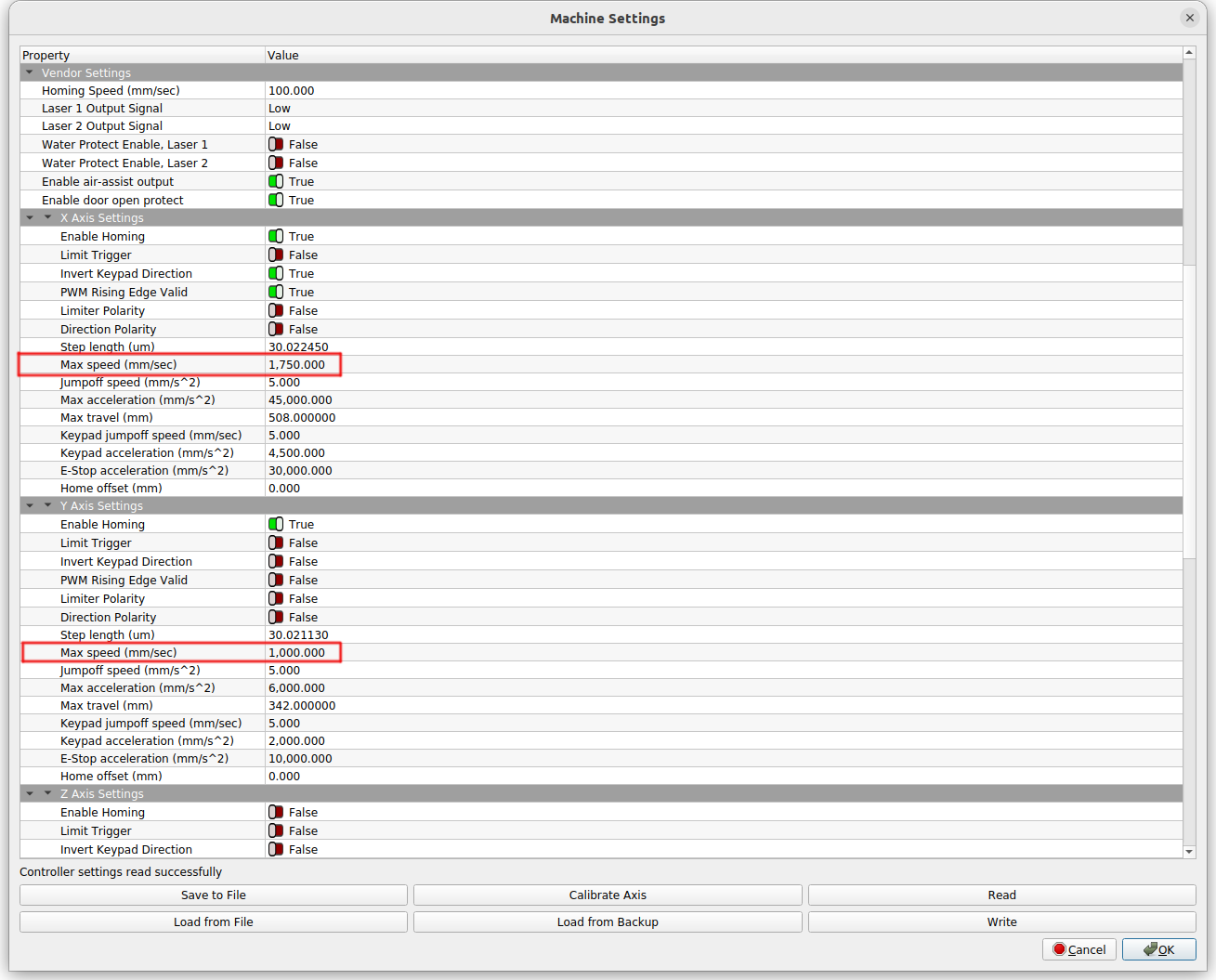

The controller is the part that enforces speed limits. If yours has a Ruida controller, the hard max is defined in the vendor settings, but in practice most of these machines will run reliably up to around 300–400 mm/s for engraving. For cutting, the limit is set more by power and material than by the mechanics, though I’d suggest not exceeding 90mm/s.

Probably mm/m, not mm/s.. 5000mm/s is 5 meters a second. I don’t know of any gantry type engravers that can run that fast.
I have a fast machine and it won’t run that fast. There is also an issue with how fast the tube/lps can respond. If you have a glass tube, that’s the limiting factor.
This is mine with a real 50W tube (1000mm in length), note the orange tube cover/extension. My machine was supposedly 50W but it was an 880mm tube, put out 43W.
People use all sorts of measurement metrics. Some are in mm/m, in/m, in/s, mm/s… need to know the units.
I suggest you just measure your tube and see how long it is. Note that the diameter is important, most of the smaller machines are 50mm diameter.

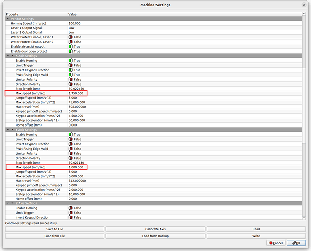

The limits are set here, within the Ruida controller. In the Machine Settings. Don’t use my values, you machine can’t keep up. Most of the time these are around 500 or 600mm/s. This limits your speed.

This answered my speed question. x = 500, y = 400

This helped give me a much better understanding. So I tried 200 then 300 at 15% and 30% respectively 1 and 2 passes each setting.. I don’t black. i do get darker, but it digs into the wood almost half the 3mm birch ply I am using.
Struggling to get black wording, or shading without digging a hole. I’ll keep watching and practicing, learning.

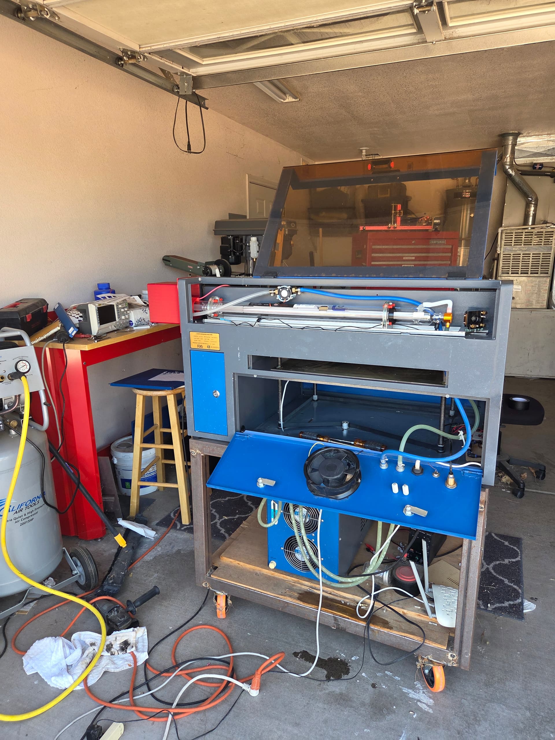

This is an OMTech Polar. They also make a polar plus that has a simplified control panel.
