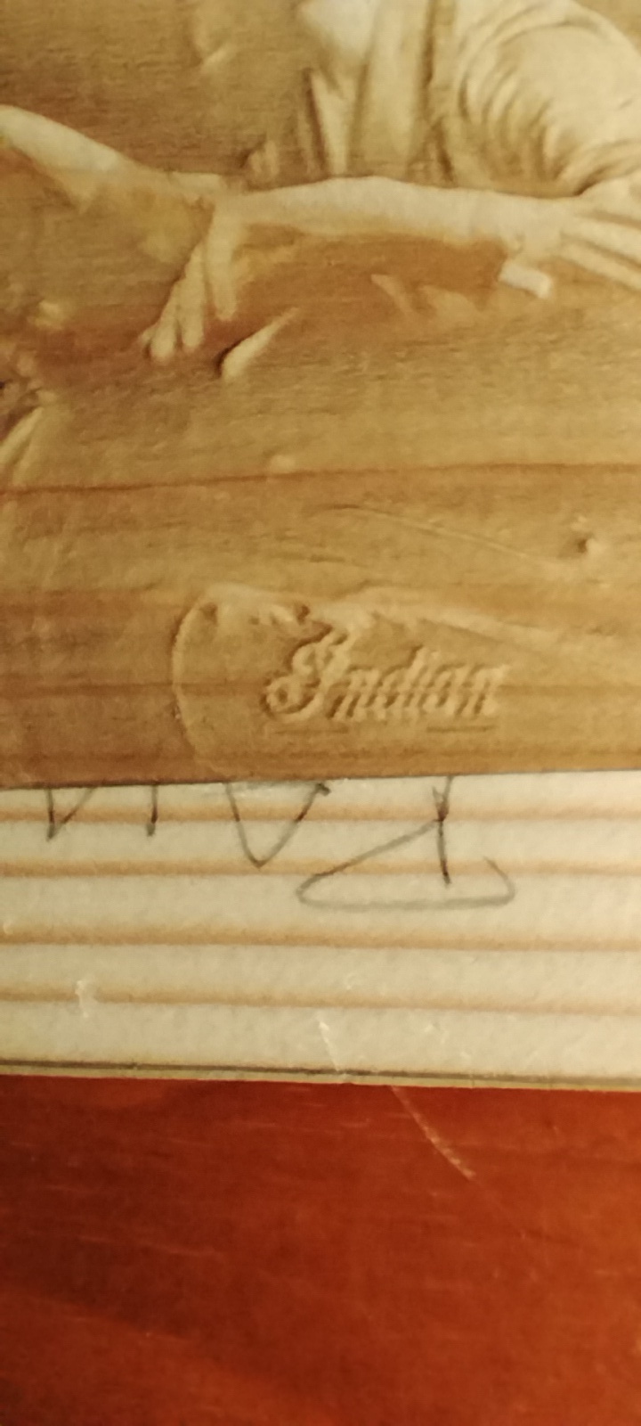

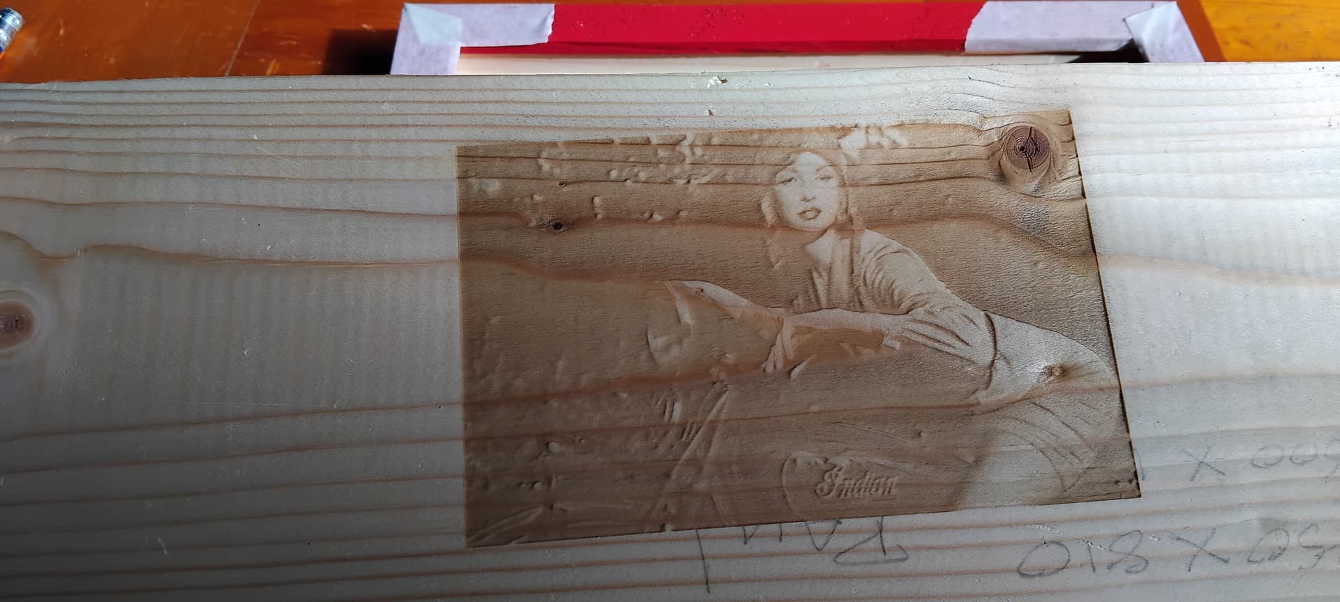

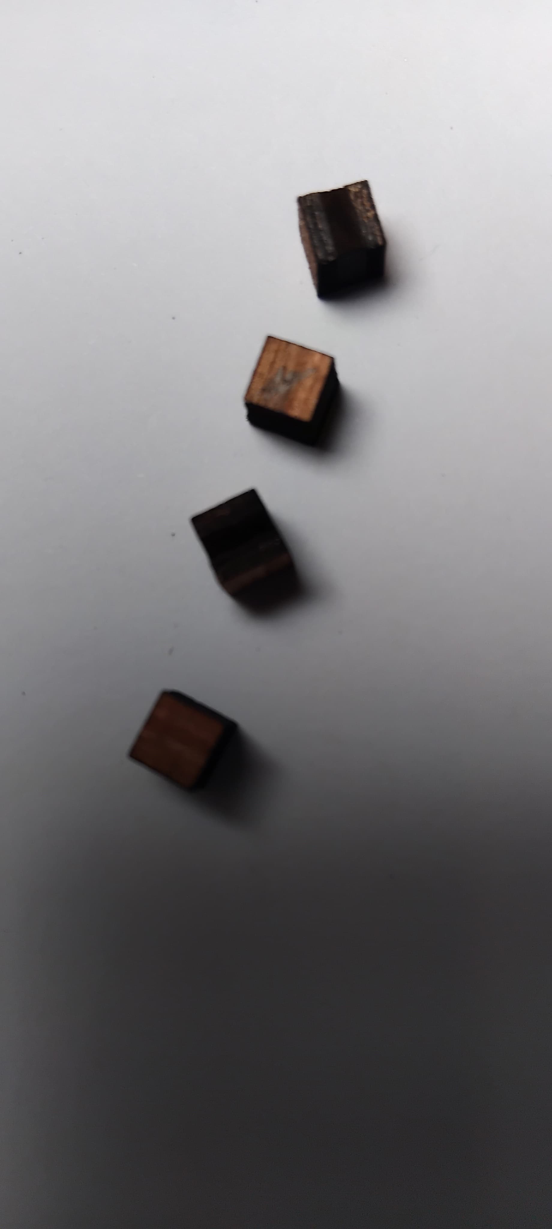

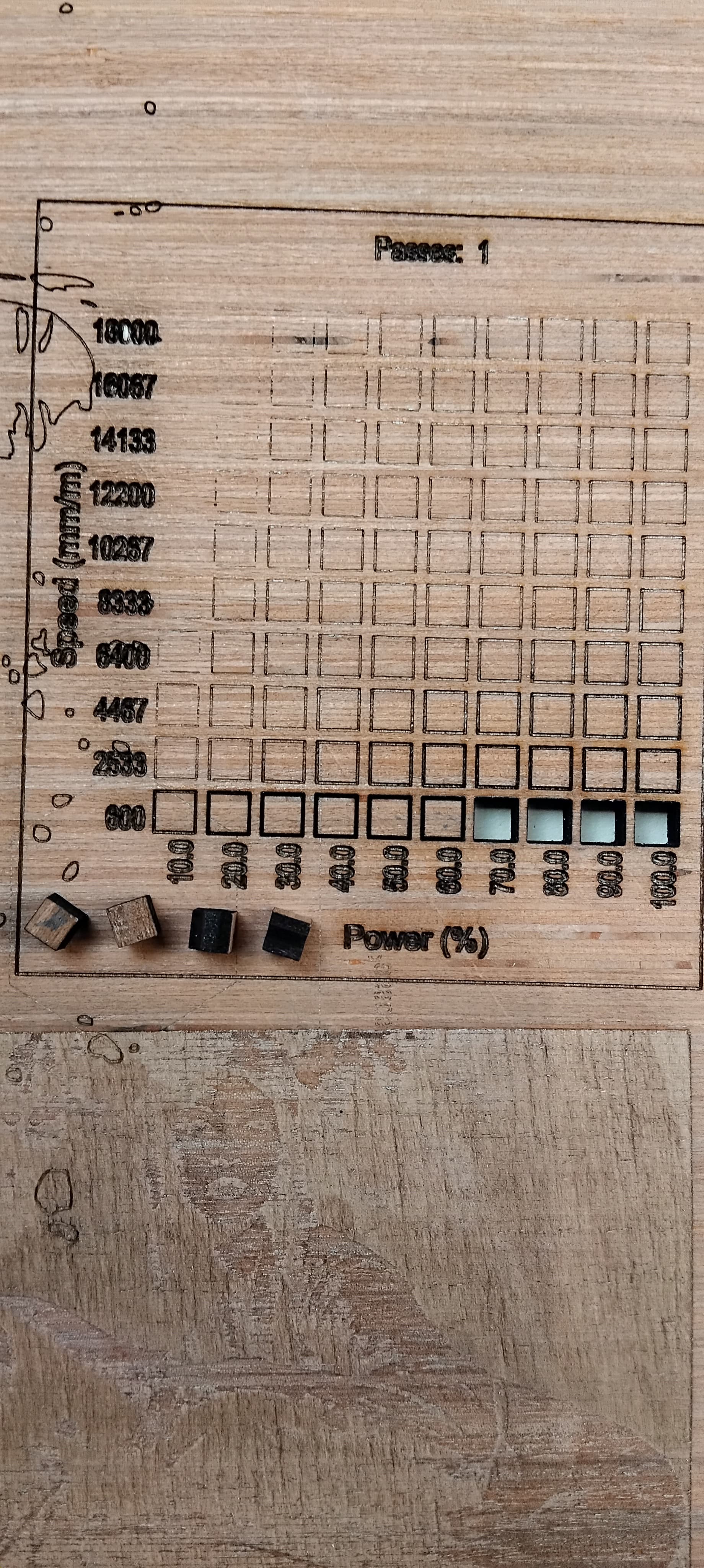

I did a power/speed test on 5mm ply with a redish type hue to it, and an image engrave on some scrap White deel.
The focus bar was set at 3mm (0 means focus is at surface).
I got a nice little relief on the white deel (fingernail thick).
Can I ask what you-all think of the results on the P/S test…and the image needs improving by getting the background removed for some contrast and less grainy material, Im picking up a sheet of 6mm ply tomorrow.
Images are the most difficult thing you can do with a laser. It is a LOT of trial and error. If you are getting a fair image, you are past the half-way point.

I was very happy with doing the Interval and S/P test and the quality of the cut but must do it again today with good focus.
