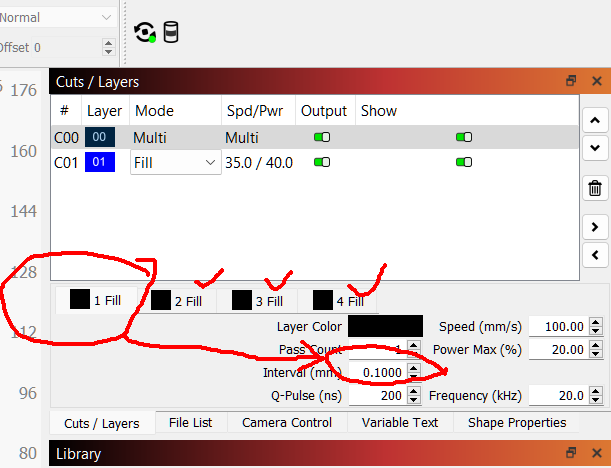

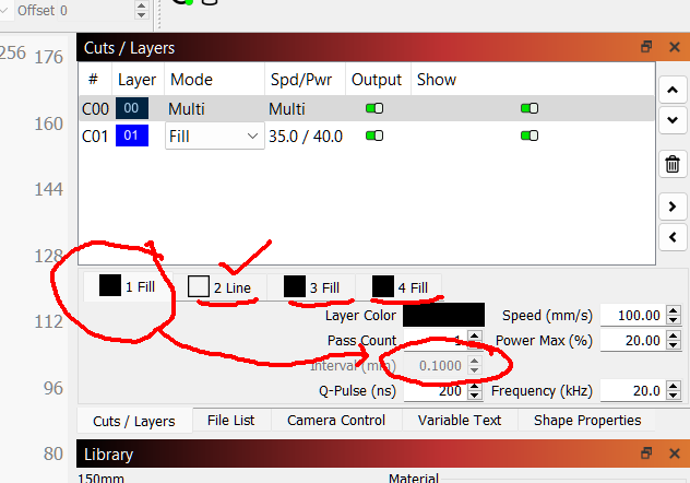

Something I noticed yesterday while working with sub-layers. Example: I’ll set sub-layer 1 to FILL mode and set sub-layer 2 to LINE mode and sub-layer 3 to FILL mode. In the box below the cut/layer box that describes each sub-layer, if there is a LINE mode in any of the sub-layers other than sub-layer 1, then sub-layer 1 INTERVAL(mm) will always be grayed out whether its in FILL mode or not. However, if all sub-layers are set to FILL mode then sub-layer 1 INTERVAL(mm) will NOT be grayed out and will be able to be edited from that box below the cut/layer box.
I hope this isn’t sounding confusing and was wondering why sub-layer 1 INTERVAL(mm) is grayed out and un-editable in these kinds of cases. I have attached snippets pointing out what I am describing above…

Thank you for reporting this. I will log this issue with our developers.
Thanks Tyler…
the same, extremely annoying. It also shows wrong number
