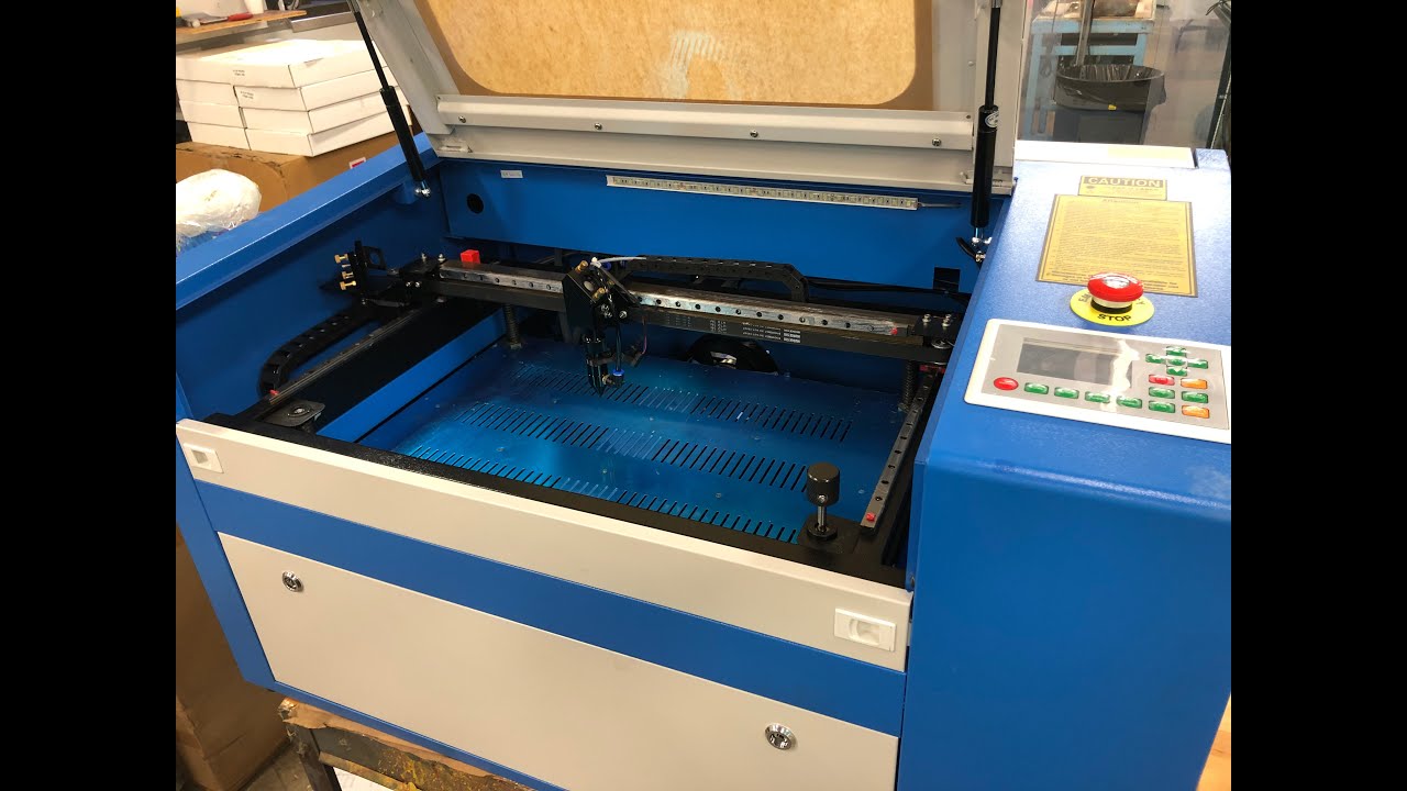

I have an OMTech 50 watt with the roller rotary. Bought off Amazon 3= Months ago. Biggest problem was the shipping and shipping damage which didn’t do any more than cosmetic damage. The hardest part was getting the mirrors aligned. I thought the machine was tweaked. It was not, you just need to follow this dudes path to align.
Well worth the price of the reverse laser to set up and follow this process. Takes much less time, much less firing of laser, and goes backwards compared to others.
I never could get ethernet to connect but part of that was that the wifi had to be stopped to do that and all sorts of changes in computer I did not want to do. Though I didn’t need to, I bought a chiller as this is a business and cannot have down time. I have not had any problems with the machine. Most issues I get are actually Lightburn related. Hope this helps. I also got some different focal length lenses.
