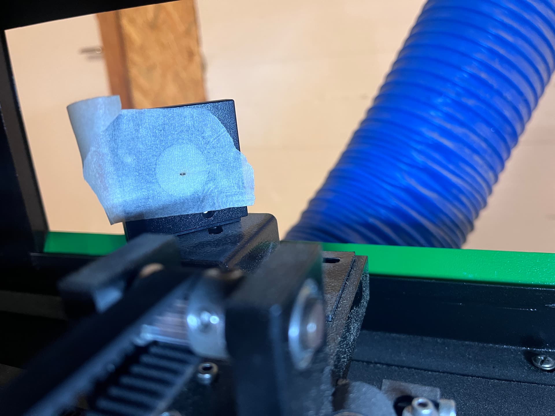

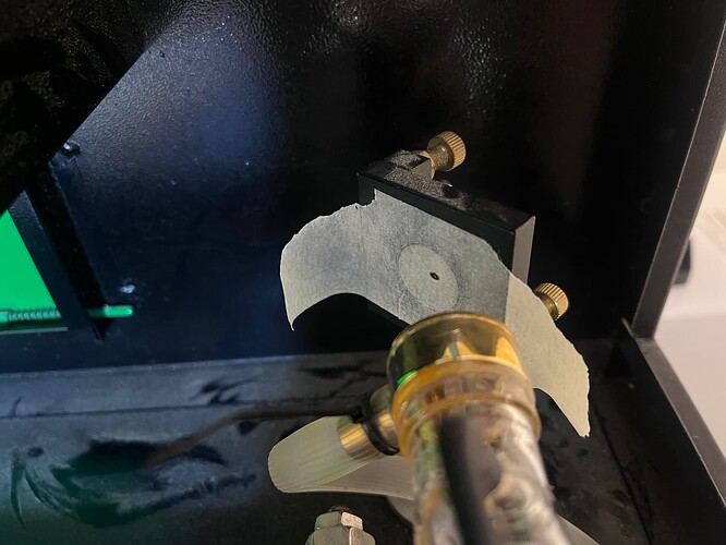

Start the alignment and post a photo of the spot on each mirror all the way to the machines table.

This is M1

Do you have a way to adjust it to the middle of your mirror. I think you have a couple more mirrors…?
Mirrors may be 20mm, but when the beam sees it, one of it’s dimensions are less than 20mm.
20mm * sin(45deg) = 14mm. 18mm mirrors are even worse.
If you are not aligned as close as possible then you could be missing a mirror, getting your beam clipped.
Now that all the photo have made it… These are not aligned, you need to re-align them. Do you have a video to follow or?
Ok, though so :slight_smile: I’ve seen plenty of videos but please suggest one and I’ll follow that. Many thanks!
Just to be sure, you don’t get 2 dots on a test shot, do you? ,asked another way, have you moved this piece of tape or why are there 2 dots?
I didnt move it actually. I think the reason why there are two dots is because I saw that my mirror has some debris on it. I tried to align the mirrors bedire and didn’t get two dots at that time.

When you are adjusting your laser beam, remember to check whether the beam comes out straight in the middle of the nozzle itself, i.e. that your nozzle is perpendicular to the frame/machine bed.
