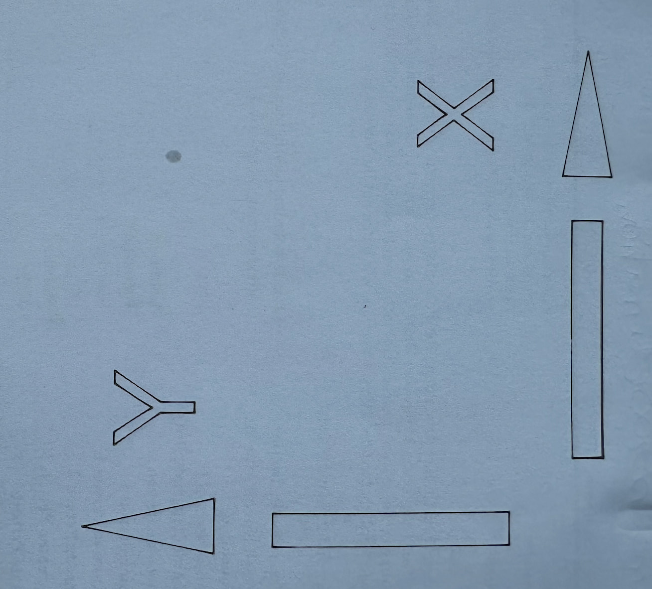

I have a problem with the coordinate system.

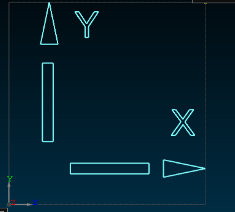

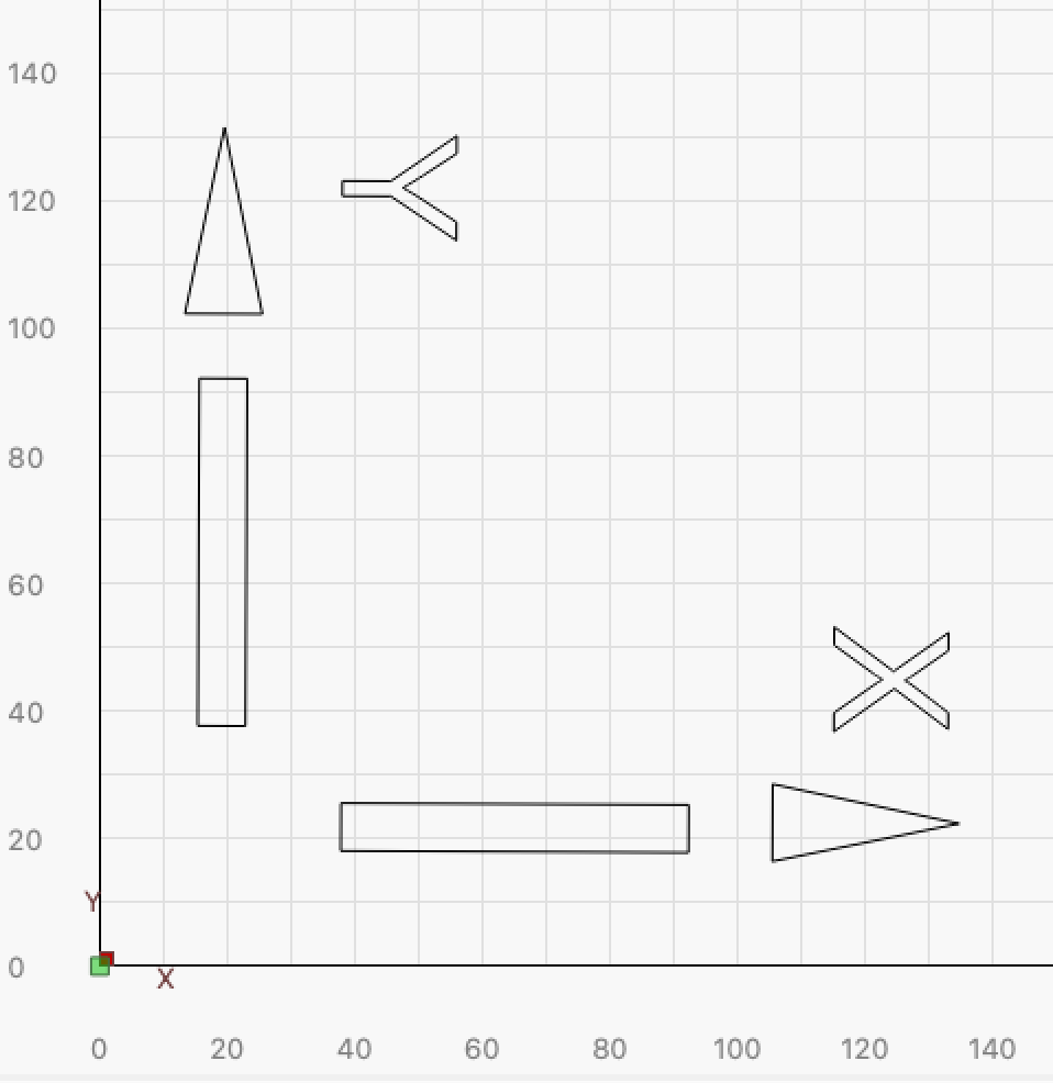

This is what I have drawn in lb (all settings standard, zero is lower right) :

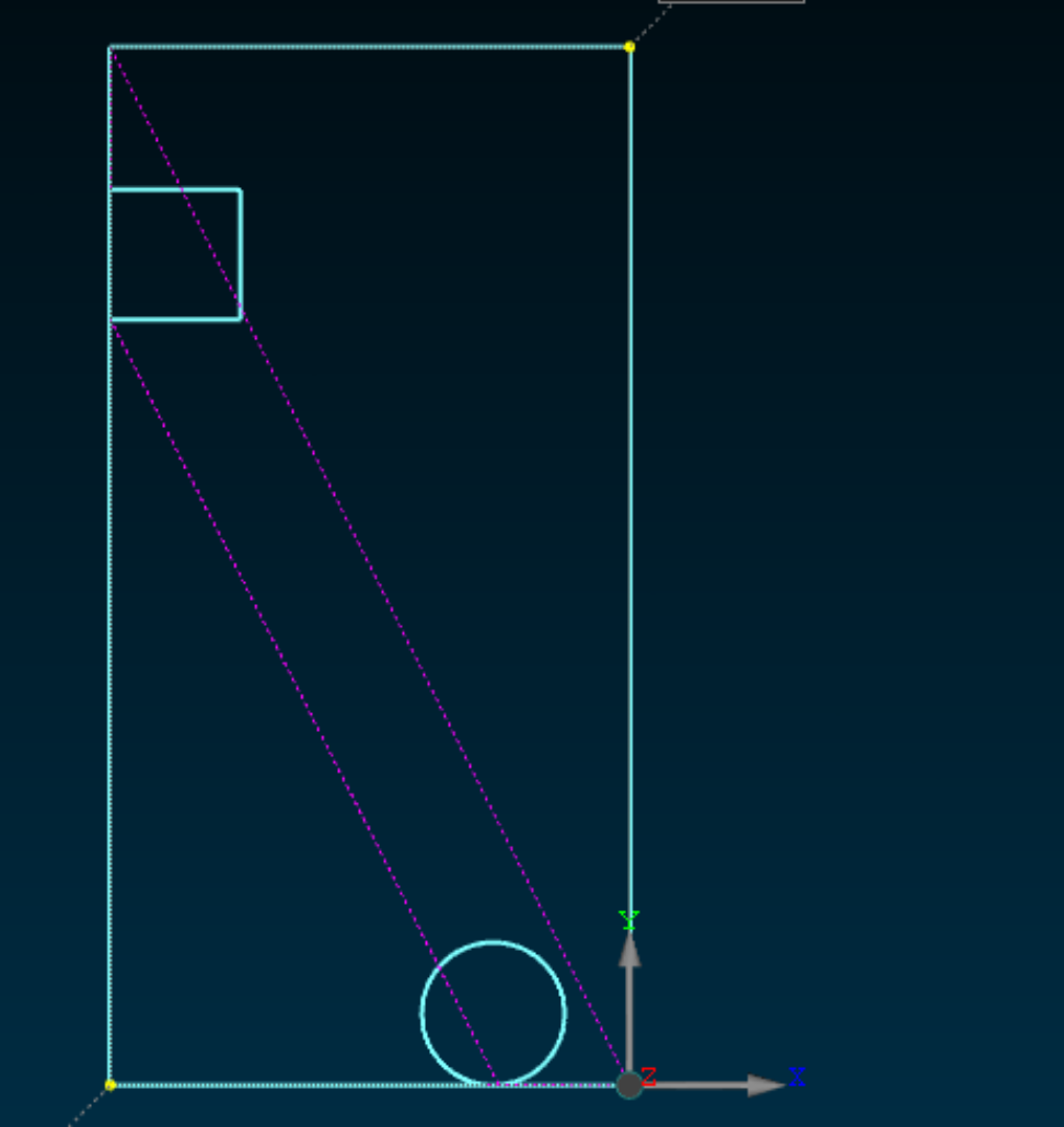

This is what came out of the laser:
The laser reference point is also in the lower right. The positive x-movement of the laser is in the direction of the x on the paper as well as for the y-axis.
So the movement directions between lb and the laser are correct. But the output would need to be flipped on the xy plane but then the axis would be wrong.
I’m a bit at a loss on how to correct that.
Thanks.

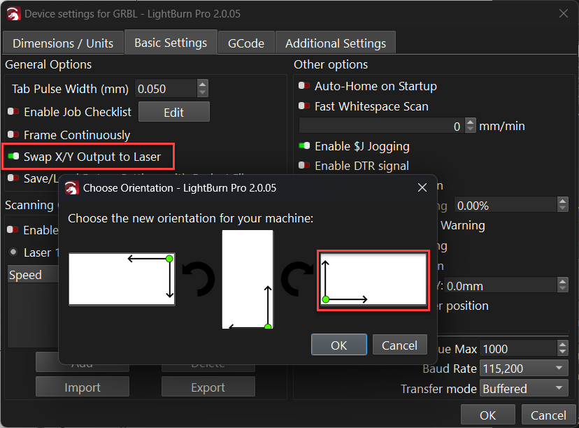

Good morning, check the machine settings to see if the X/Y axis swap is enabled. It’s located under Laser Tools - Device Settings - Basic Settings. Let me know how it goes.
I saw that options but as I understand it, it ‘just’ rotates the coordinate system. That won’t help me here. The output would have the right orientation but the machine axis would be wrong.
Or am I misunderstanding that option?

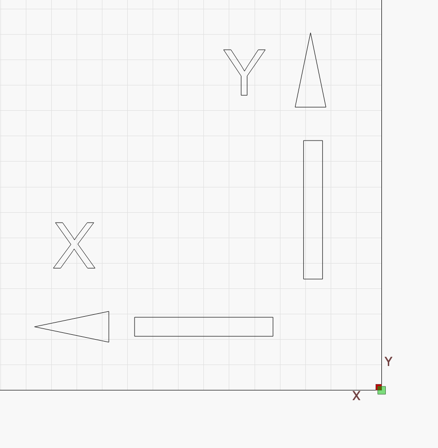

It looks like your output has an Y=X swap applied already like this:
If your “Swap X/Y Output” is not currently enabled, then you would need to do enable it now if you want to swap axes.
Try this:
Enable ‘Swap X/Y Output to Laser’
Select one of the rotate 90deg , and ‘OK’:
Then go back into device settings and set device origin to front right again, so the positive directions stay the same but the X/Y swap is active.

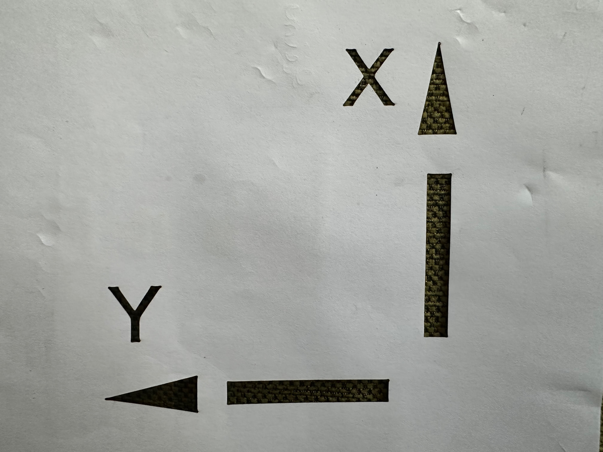

Ok, tried the swapped device. Unfortunately, everything is wrong except for the orientation of the characters. X & Y are swapped, and the reference point is bottom left instead of bottom right (although it shows at being bottom right). OTOH, the ‘X’ & ‘Y’ characters now have the correct orientation (but are placed on the wrong axis).
I’ve also tried to swap (with the setting) this file. No change.
I’m a bit puzzled how this can go so wrong. Or is it ‘just’ the problem that x/y swap doesn’t work for Linux CNC devices?

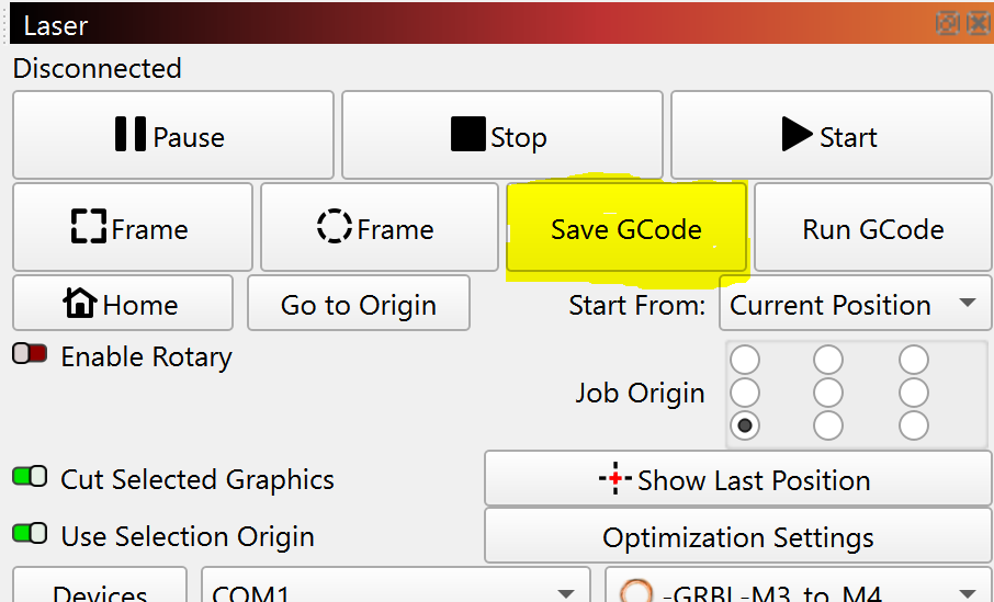

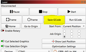

What is more important is the option ‘start from’ which is not located where the other options are but on the main screen under ‘Save gcode’. I guess there is a reason for that, but it had me surprised. I had to set that to ‘absolute coordinates’.

This is the input in LB:
which gives me that output:
