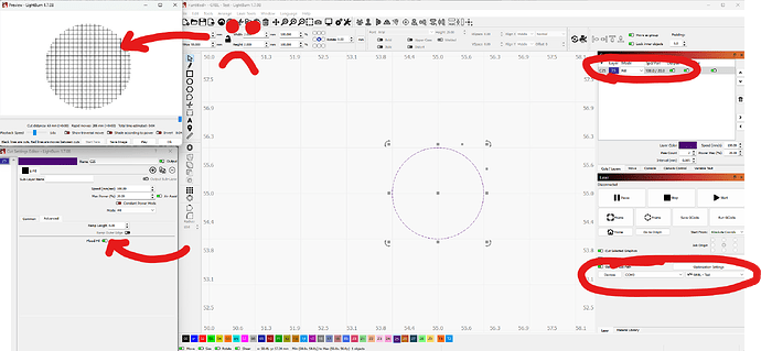

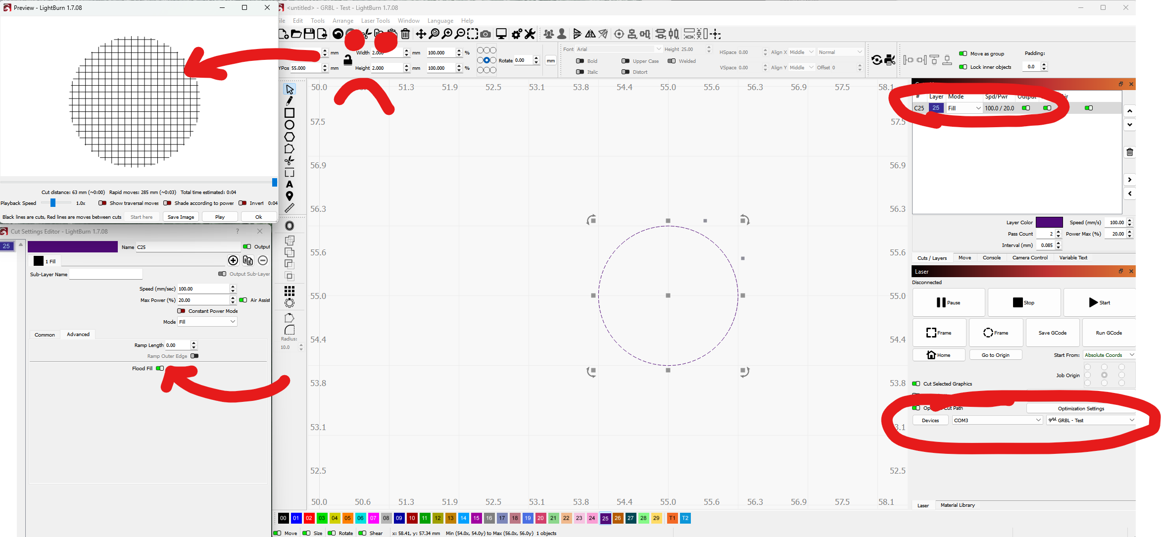

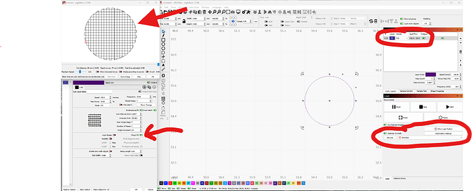

I’m using an xTool F1 Ultra which is GRBL based apparently and I have an extremely specific / niche application where I need flood fill to be active. However, it seems the ‘Flood Fill’ setting in the Advanced tab doesn’t change anything. The circle previewed below is just for reference to show the issue. What am I doing wrong?

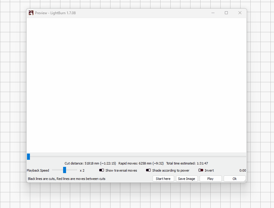

Preview and settings with flood fill enabled on BSL type laser, this is what I’m looking for:

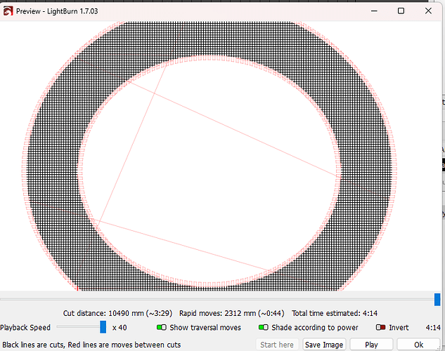

Flood fill enabled on GRBL type laser (generic default profile), no change if it’s ticked or not:
Also there doesn’t seem to be an option to replicate the Angle Increment setting from the BSL menu and I also really need that. The F1 Ultra stock software comes with an ability to do this, is there somewhere I can set that up?

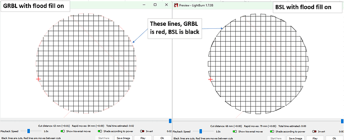

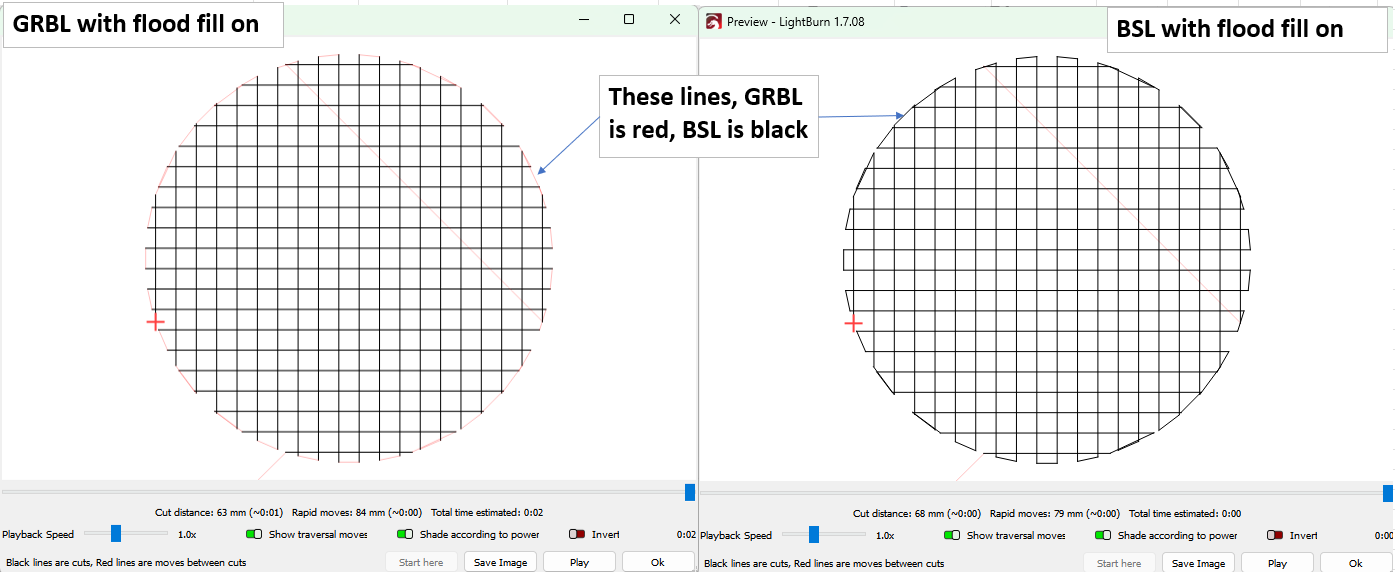

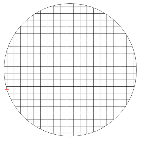

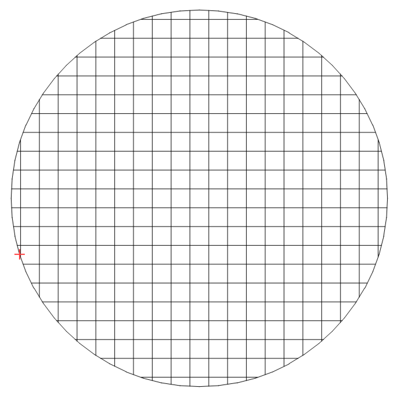

Thanks for the quick responses! It appears I wasn’t clear enough in my original question, my apologies. I understand the general intent of flood fill and know that a circle is not strictly relevant to the ‘flood filling’ part but it still demonstrates the issue. I attached a side by side picture of what the preview looks like for the BSL laser flood filled and the GRBL laser flood filled (showing traversal moves this time as well).
Basically for the GRBL laser path the laser has traversal moves (red in the preview) between scan lines and it doesn’t cut them whereas the BSL laser does cut them (they’re not traversal lines, they’re black). This may seem trivial but in my actual use case it’s more impactful and results in significantly cleaner cuts. Offset fill did not work in this case unfortunately and produced much rougher edges despite fiddling with it for a bit.

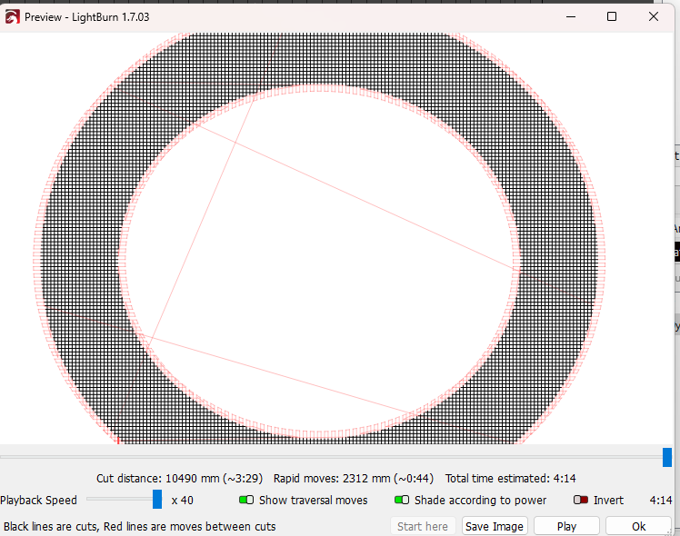

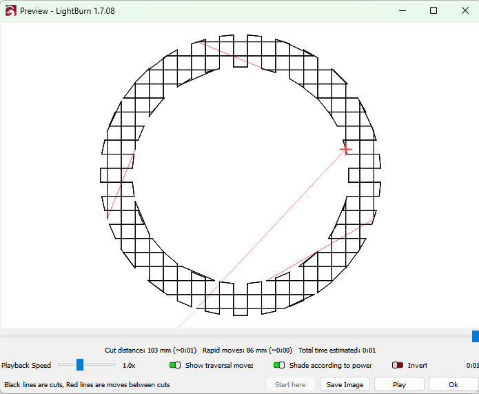

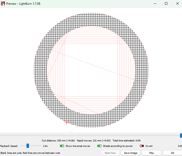

Looking at it more the flood fill just seems to behave very differently for the GRBL lasers, it doesn’t seem to try to avoid white space, see the preview pic below showing how the BSL laser flood fill does what you would expect but the GRBL one goes over the white space in the center.
BSL (no lines in the center of the ring being engraved)
GRBL (red lines go through the center of the ring) :

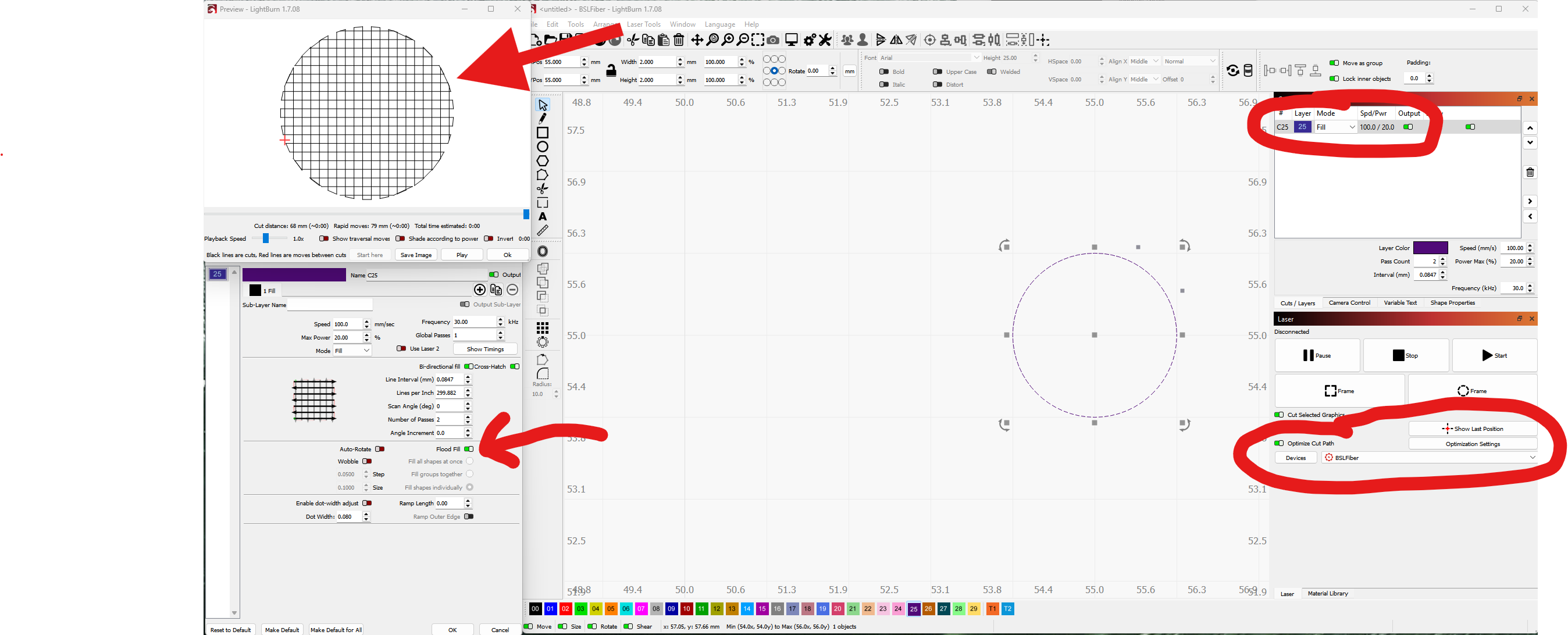

My GRBL machine (Ortur LMP2) on version 1.7.03 does not have the problem you describe. Crosshatch and flood flll enabled.

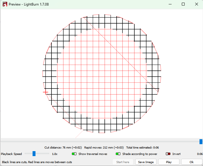

And thanks for testing it! You actually do have the same issue where it’s not cutting the edges between scan lines (they’re red not black) but it does indeed flood fill so you got me thinking that perhaps the small size of my part is a problem and indeed that seems to be the case, it was only 2mm OD. If I just scale it up by ~5x it transitions to doing what you show, this image below shows it in the middle between both modes though. It seems to enter a mode where it just connects lines instead of flood filling so it must be a tolerance setting I can’t seem to find that isn’t noticeable at larger scales. It should be noted though that this only happens with overscan off which is what I’ve been doing but I noticed you have overscan on and indeed that makes a difference, this small bridging goes away with overscan being on but I don’t want the overscan so I just set the % to 0 and that seems to finally flood fill my tiny shape properly so that’s progress! I didn’t expect turning it off vs setting to 0 to behave so different but that’s good to know.
That said, it still doesn’t cut the lines between the scan lines which is important and I also still haven’t figured out how to do the angle increment setting where it gradually rotates the scan angle which I’ve also found to be important. Any ideas on how to solve those two?
