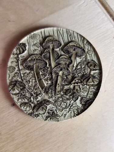

There’s not a great amount of difference in the levels of grays in your image and I think you’d get better results with a larger lens, a 110 mm perhaps. With a 50 mm your focus has to be exact, as Jack says. Here’s a good grayscale depth map image you could try. Note the levels of gray in it.
Thank you for all the tips. I just ordered a 110mm lens to try. I’ll update everyone on my progress. Thanks again.

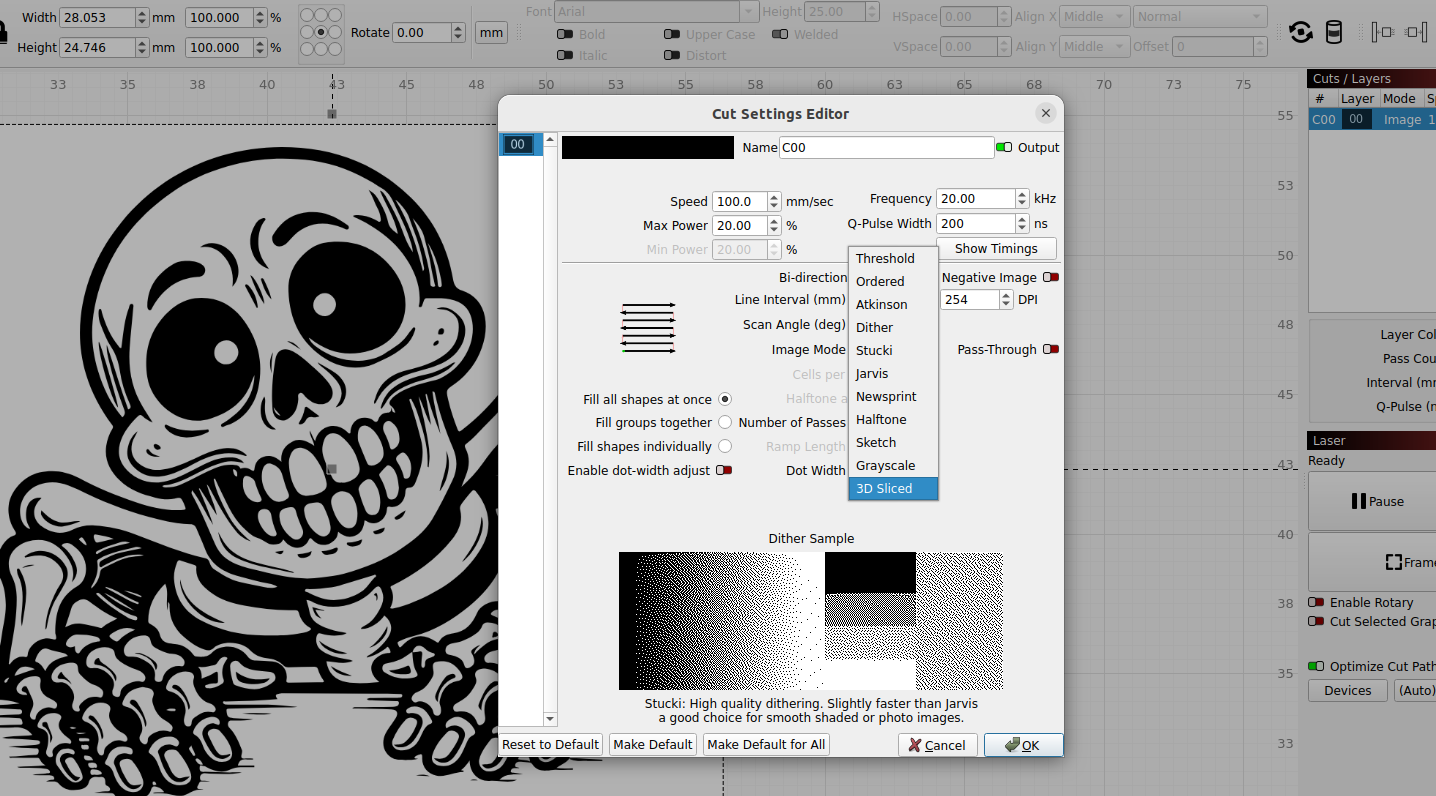

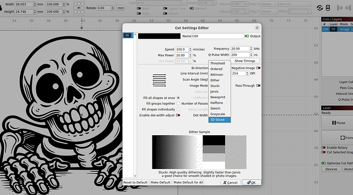

I think I missed the point here immediately as I’m having a “moment” and am clueless how to get to 3d sliced. Trying to make a nice Jessica Alba “tails” on a coin here (yes, I’ll post when I’m done​:joy:) but I get “3d slicing” when I go to adjust image butt :backhand_index_pointing_left: when I adjust settings “although created in depth-r as a png… I have no option when it’s time to go and hit start. Why? I thought that was the original question here. I have galvo selected, a 110 lens butt :backhand_index_pointing_left: the option to 3d slice is nonexistent. Help?
If you have an image, you should see the option in image mode. This is only a b/w png image with no depth marking. I can use it with 3dslice, although kind of a waste, but the option is there.
Let us know how you’re doing this and not getting that option.

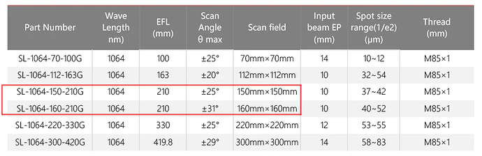

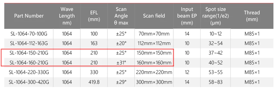

Might want to post the actual F focal length number, not a coverage. My F100mm has a coverage of about 70x70mm.
Also notice that the F210mm lens is available with two scan angles…
