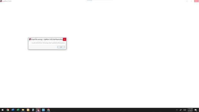

All of the sudden I stopped being able to load a design from my art library. I’ve tried reloading the art library and it still won’t work. If I try to add the design it causes the program to “Stop Responding” I tried to open the original saved file and it says it cannot load a font. I’ve tried uninstalling the font and reinstalling it. That doesn’t work either. At this point, I have a customer that wants a design that I cannot open. Any help would be great.

Can you post a screenshot of the error that you get?

When I try to load the file from “File Open” it just freezes. The same thing happens when load it from the art library. The only reason I know it is font related is when I directly launch the program by clicking on the actual file from a windows explorer.

If the file is corrupted the error may be a red herring. LightBurn would normally fallback with a different font if the font wasn’t present.

Interesting. The file does not in fact look corrupted and may in fact be font related.
I manually edited the .lbrn file to swap all fonts to Arial and the file opens. Hopefully this allows you to recover the design.

I was able to replicate the crash on public beta 1.5.0 on Win11.
Thanks so much. That worked!!
I can recover it from there. Thanks AGAIN
