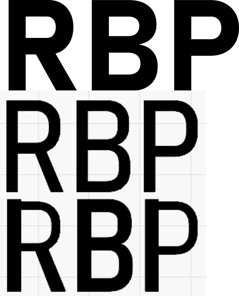

I have version 1.7.08 (also did the same with 1.6.0) and the .ttf font Bahnschrift (which I believe comes with windows) doesn’t display the R and P characters correctly in bold. It looks like only part of the letters is bolded
Any thoughts? The top is bold in inkscape, the middle is not bold in Lightburn, and the bottom is bold in lightburn.
Thanks,
Steve
I can confirm that I also see this with the same font on version 1.7.06. Looks fine in Affinity Designer.

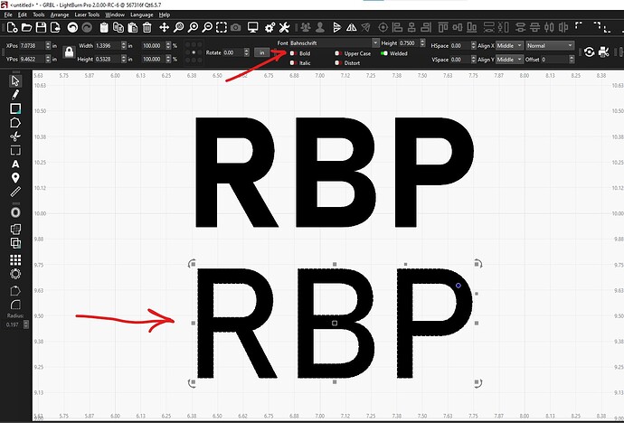

I experienced this issue with version 1.7.08, but it seems to be resolved in version 2.0.00 RC-6.
These are the results from version 2.0.00.
