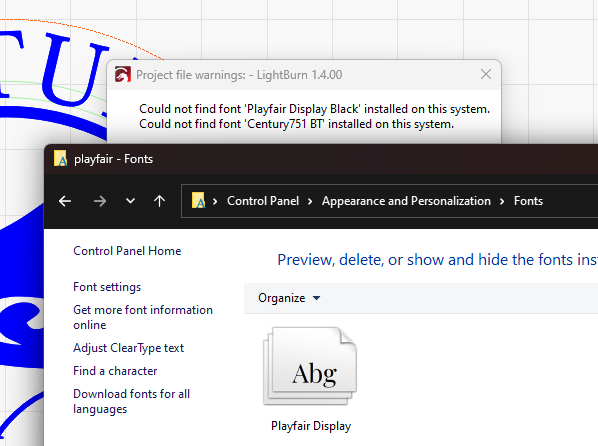

Hey I’ve been using this font without issue for some time now but when I open the program it says font not found.
You can be sure its installed, as can be seen in this image.
What could be the issue here??

I can assure you the name matches and the solution is related to something in Lightburn, I think you reference my previous photo where the font appears as part of a stack.
When the stack is open you can see them all…
Name is identical.

I have a feeling this fix will need to come from Lightburn. I don’t know if this program is caching the font names or what but no other software have this issue. And I have close to 7500 fonts installed.

I know the cross-platform development environment we use has some limitation on the length of the font list because it starts to get extremely slow at some point. Checking with the team, over 2000 fonts, we simplify the rendering to assist… Beyond about 4000 though, these limitations become much more apparent. ![]()
