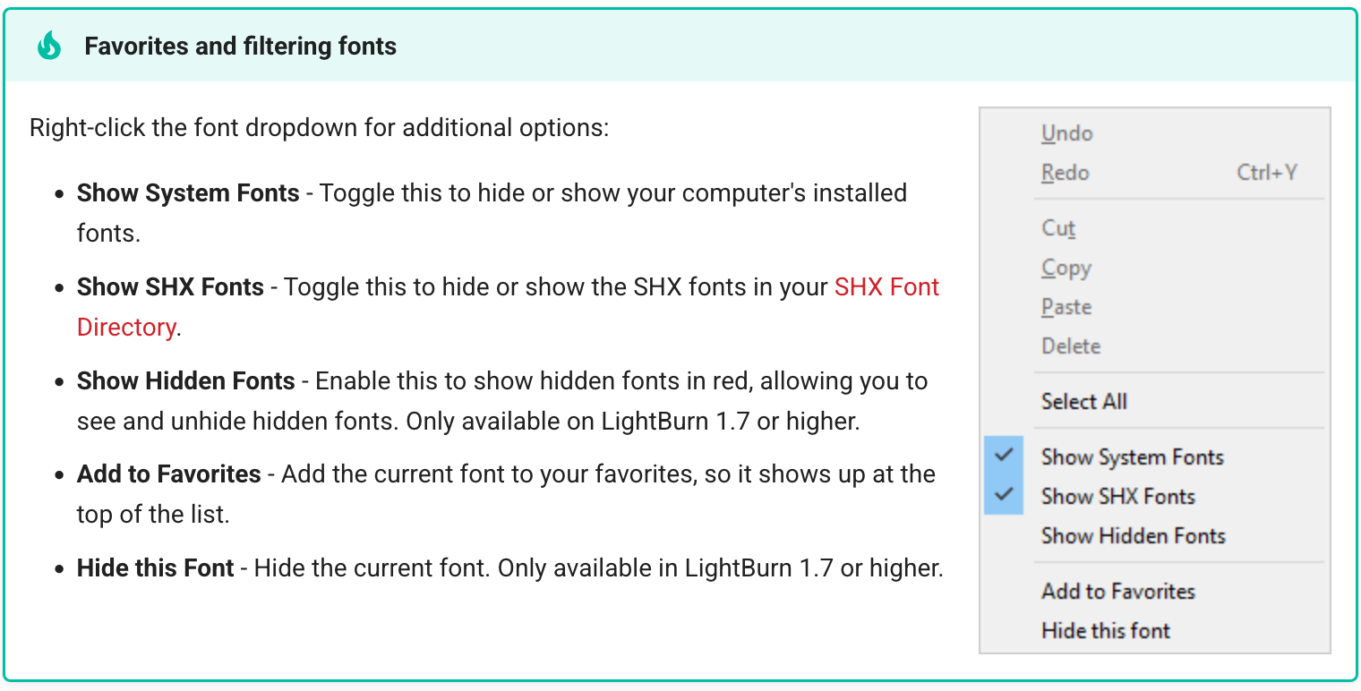

Some of this work has been completed, which you can read about here:

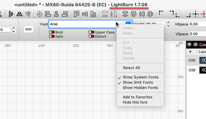

Is this only for the PRO license? My pull-down (v1.7.08) does not have the entries you show below the Select All line.
This feature should be available for all licenses of LightBurn. Please show us what you are seeing when right-click the font selection drop-down with some screenshots. I have not personally seen what you describe. :slight_smile:
Here’s what I see
Yes. If you add a font or fonts to your favorites, hide some or install SHX fonts, you will see that menu change and show additional, context-sensitive items to that menu.

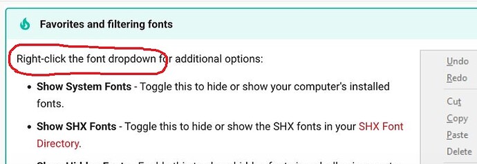

I think I found my problem…
I missed this in the instructions. Bold font would have helped!

I put a request to have the doc team review and adjust for greater visibility / clarity. Thanks for the suggestion.
