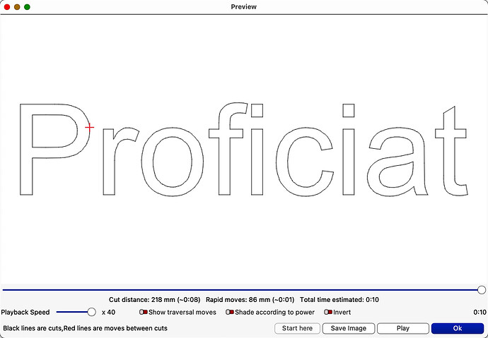

The preview and engraving of text is not correct only when connected to my Sculpfun S30 Pro Max 20W. When I am not connected to the laser, the text appears normally.

Can you upload the .lbrn file here for review?
But I want to make sure I understand the point that you’re making. You’re saying only if the laser is plugged in you get this issue in Preview? So as soon as you unplug the laser the Preview appears normal? Is this 100% repeatable?
If so, this would be extremely unusual.
Since it’s already broken in the preview screen, this should have nothing to do with the laser / firmware etc. So, it’s at LightBurn stage.

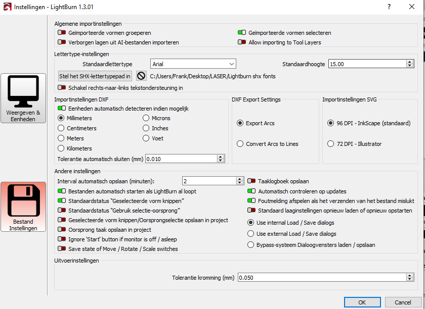

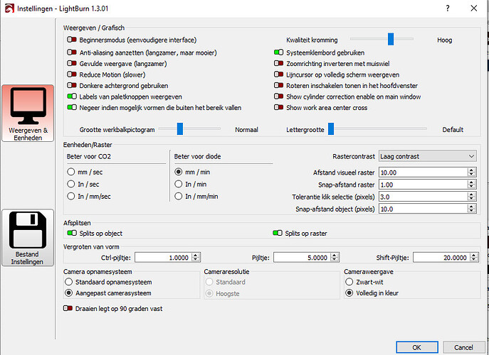

Can you give a screenshot including all your settings?
And also the LightBurn settings, there are options for antialiasing, rendering etc.
Additional explanation to your request:
Only if I start Lightburn with the laser on it gives this bad preview.
If I start Lightburn with the laser out, the preview is normal. However, the engraving remains poor as in the bad preview.
I can reproduce this every time, starting Lightburn with the laser on.

Please find the requested information here.
I’ve already tried changing the antialiasing setting but it makes no difference.
Thanks in advance for your help
You have a negative kerf offset which will collapse the letters onto themselves
I set that value to zero and the Preview looks as it should
This is what I had assumed was going on but then the greater mystery is why the Preview is showing the “incorrect” view without the kerf reflected if started with the laser connected…
For sure. Laser connected = Preview correct, but still burns wrong? That’s how I read it anyway.
Very mysterious
