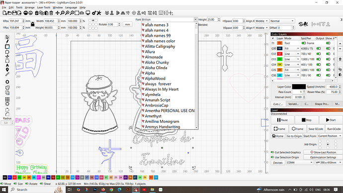

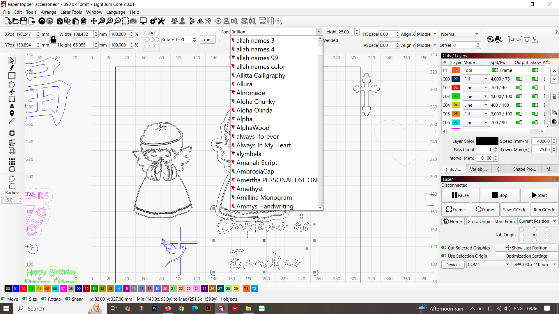

Hi again! I’m still having this issue. Can anyone help me? Font style not displaying in the dropdown.
Can you tell us what is actually missing? My Windows list of fonts show none of those, so I have nothing to compare them to.
I have learned not all TrueType fonts follow the standard format on how they are built.
It doesn’t show their styles in the dropdown. A preview of the font I want to use.

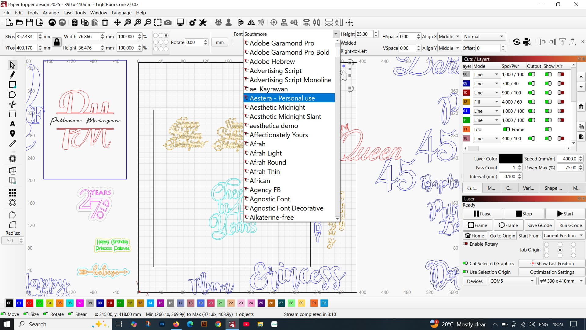

I see you are on 2.0.01. Try upgrading to 2.0.03 and see if that resolves the issue.
That is a known issue with some fonts. Not a lot of them, but some installed fonts don’t display correctly in LB, but display correctly in other programs.
Yes ok! However, none of my font styles is being displayed in the dropdown. Can 1 or more fonts cause this issue? Or do I have too many fonts installed? What could it be?
