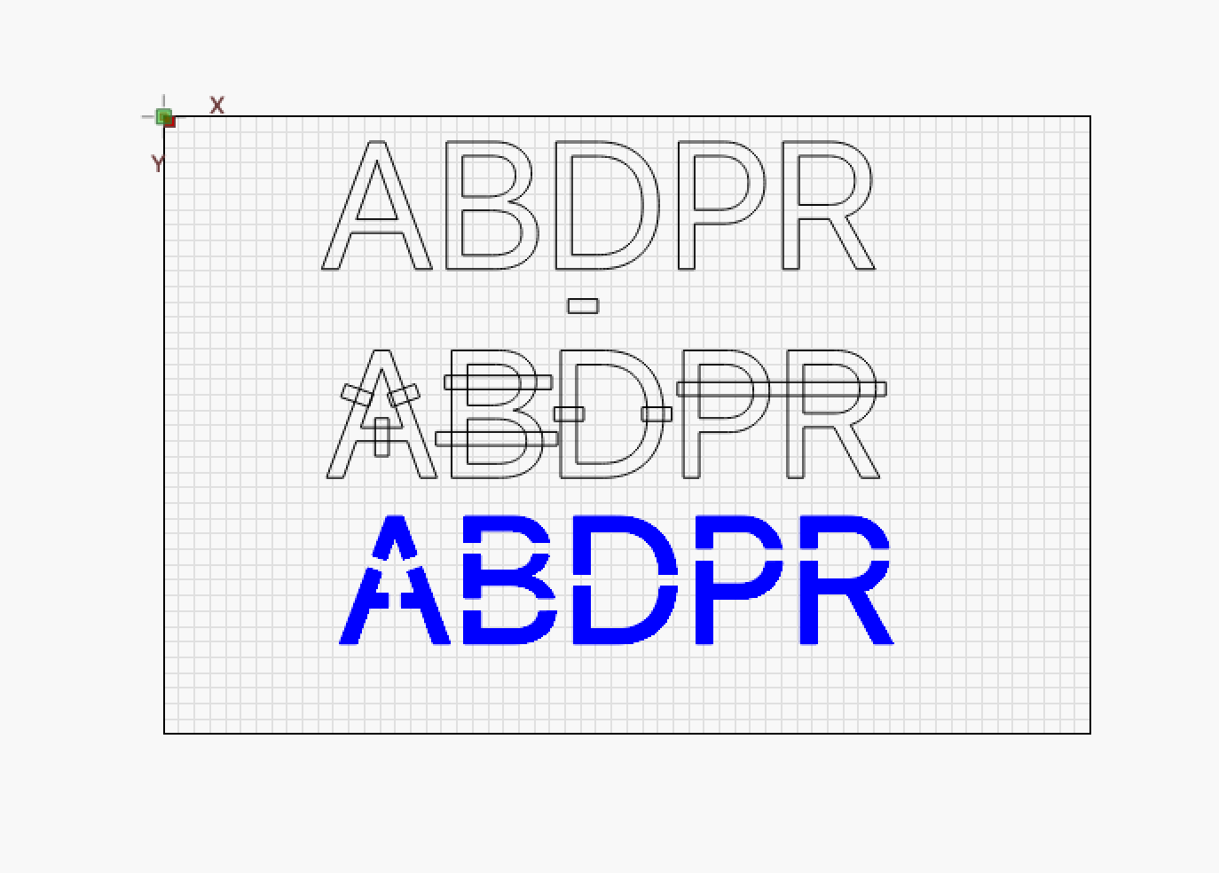

I have “stenciled” several fonts. Easy to do and not all letters in your text needs to be “fixed”. Drop little rectangles across the letters needing fixing, and use the Scissor Tool to clean it up. Of course, text gets a Convert to Path treatment first.
You can also play around with LightBurn “manually” :wink:
I only used scissors for that - fantastic tool
