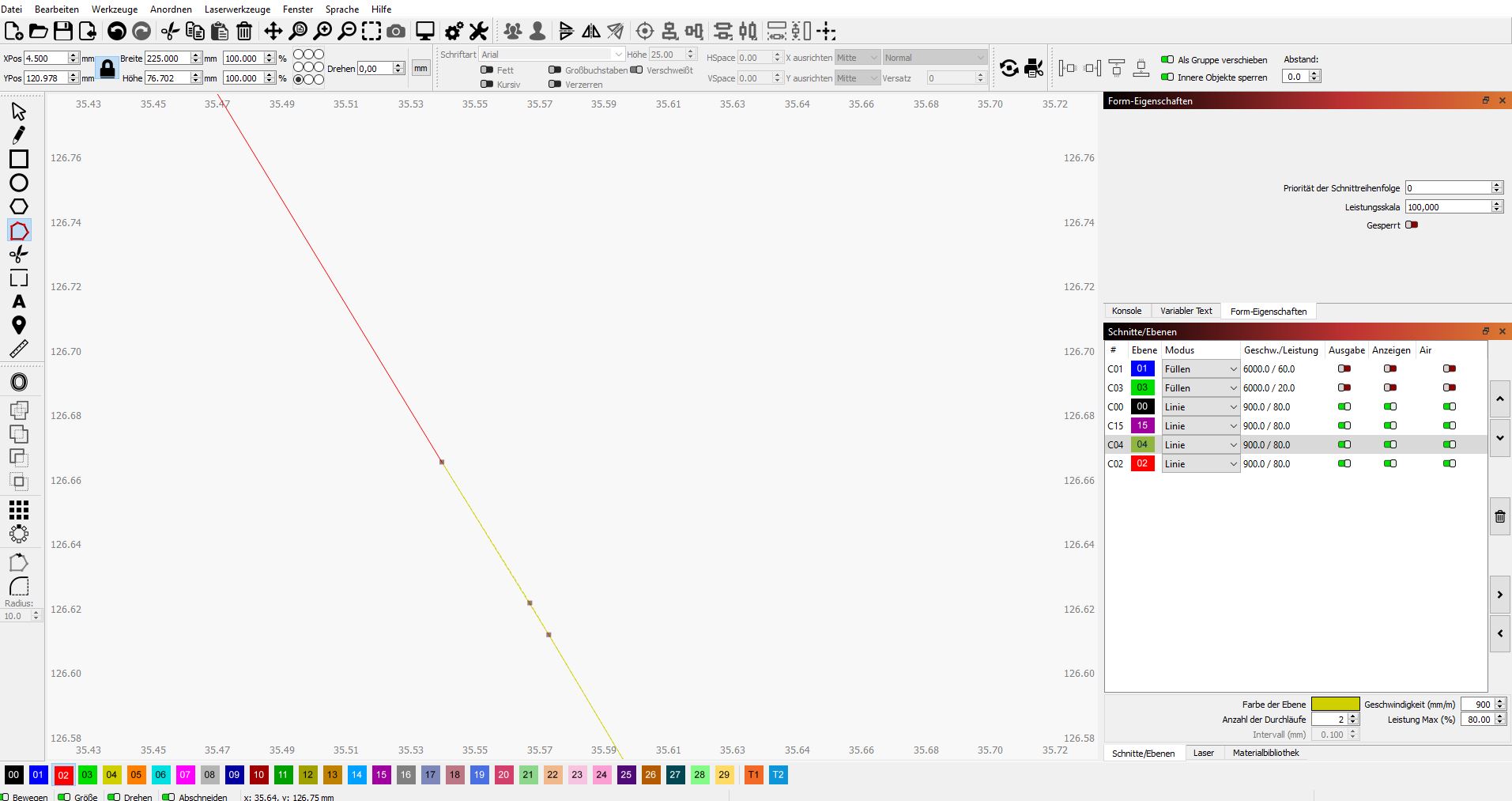

Hello,
I want to connect a line (red) and a shape (yellow). These are actually black, but I’ve made them different colors for better illustration. When I look at them with the node tool, I see that the shape (yellow) doesn’t have a start point (green circle), only an end point (green square). However, the line (red) has both.
I’ve been trying for 3 hours to connect these shapes, but it’s just not working.
I hope my problem is understandable, and that you can possibly help me.
If it’s an open shape and editable, it should work. Try showing a little more from your challenge.
…you should probably have both parts set to the same layer.
