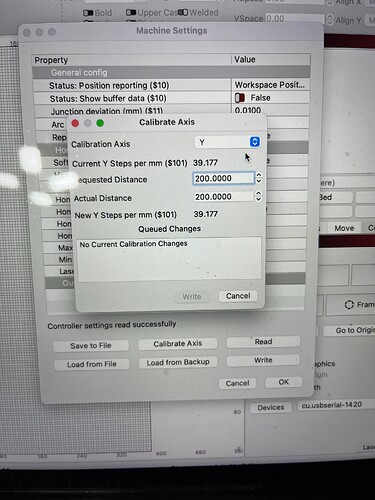

My machine was working great for the past 6 months. Something happened and one of my settings was messed up by my wife. My machine goes home every time I start up the Lightburn program. Then when I hit get position it says the position is X axis -377, Y axis is -354.02. Then when I hit go to origin my machine goes all the way to the other X axis and a little up the Y axis. I hit show positionWhen I hit the travel to a location the switch limits are maxed out then. I will also include pictures of my settings.

Also check your laser $100 and $101 values
I gave that a try and it still isn’t working. I wish I could post a video on here on what it’s doing. What settings do my $100 and $101 need to be. I have them set to what is recommended.
Type $101=80 press Enter.

Also your laser GRBL settings have $30=10000 and S-Value Max set to 1000.
In Lightburn Console window type $30=1000 and press enter.

In Console window type $RST=# then press enter.
Close and restart Lightburn, run $# and post here the output.

One at a time input these commands in Lightburn Console window pressing enter after each:
$RST=* ( then with mouse-cursor select all the output inside console window and copy/paste here in a post)
$13=1
$21=1
$25=500
$27=3000
$30=10000
$32=1
$110=3000
$111=3000
$120=400
$121=400
$130=380
$131=780
And check if your limit switches are ok.
To make it easier switching to Router mode set S-value max to 10000.
