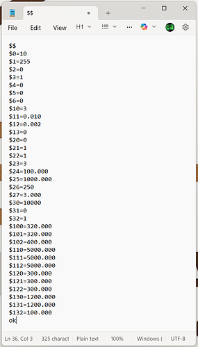

Can you send a screenshot of your devices window, and send $$ in the Console and copy+paste the response it prints here?

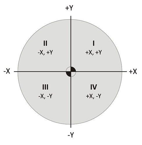

You likely have your origin corner set to the wrong corner of the machine. The CNC machine switch allows LightBurn to send out negative coordinates - most lasers are only positive coordinate systems.
Thats the quadrant I in the above image. The CNC machine switch allows for negative coordinates to work.

Hi Colin, here’s the screenshots you requested
