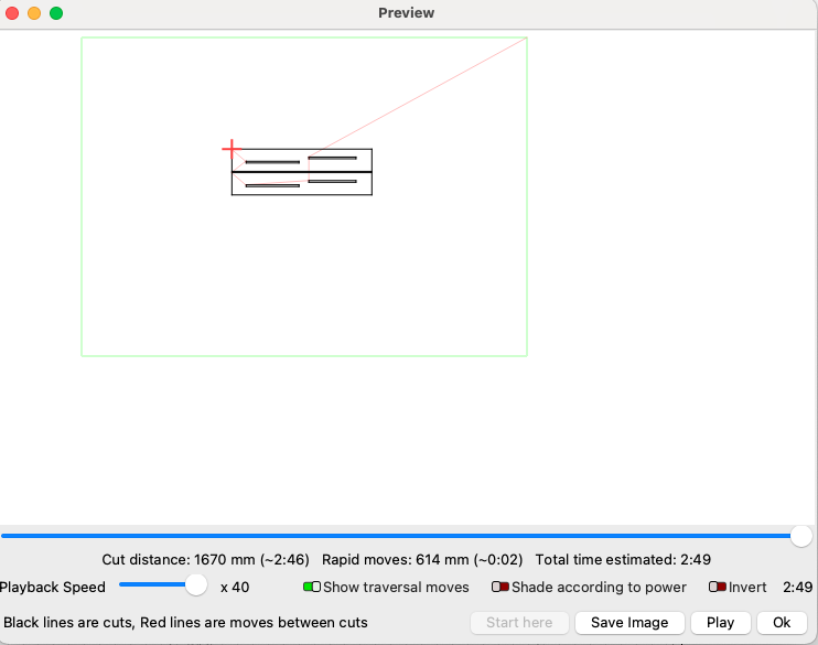

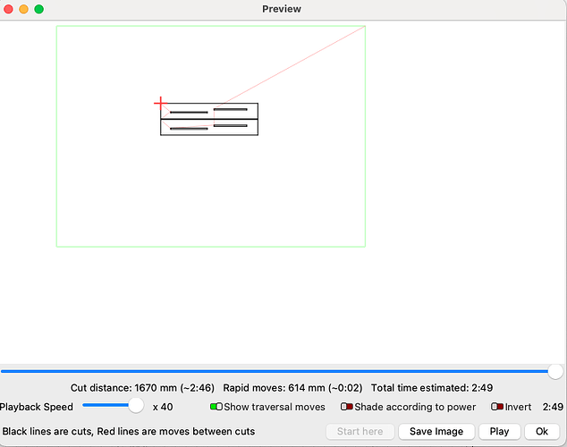

I have checked the boundary via the preview window and my design does not extend beyond the green border. Even when I am cutting a smaller shape in the centre of the machine the frame button does not work. I switched over to Start From: Absolute Coordinates and I am still running into the same issue. I just tried to do a Material Test Generator and the frame button would not work even though the design was in the centre of the workbed.
Do you have any other suggestions?

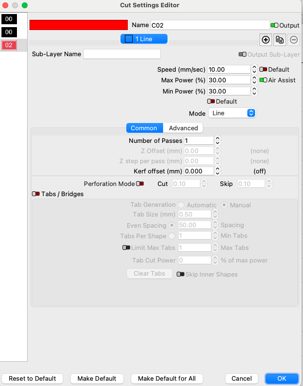

Upload screenshots (not phone pictures) of:
  • The Preview window with Show traversal moves turned On, zoomed out to show the machine boundaries
  • The Laser window
  • The Cut/Layers window
  • The Cut Settings Editor window for that layer
Then we can peer over your shoulder and see what you’re seeing …

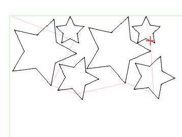

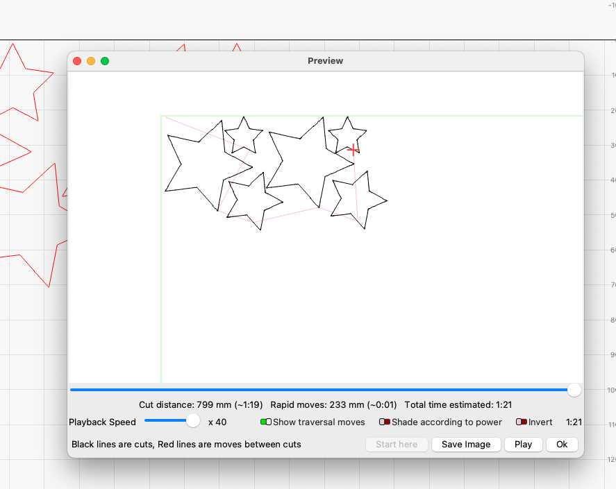

Screenshots below:
The Preview shows the design will appear in the left-rear corner of the platform:
The tips of the upper stars appear to be exactly on the green line marking the rear edge of the platform. I cannot tell whether they extend slightly beyond that line, but there’s no daylight in between.
The thin red line from the upper left corner shows the laser head’s current position is in the left-rear corner, which is likely where the machine homes.

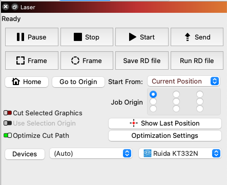

The Laser window shows Start From: Current Position with the job origin at the upper left corner of the design.
If LightBurn calculates the frame as sitting exactly on the bounding box of the design, the laser head coordinates will start at the home position. That means the rear of the frame lies exactly on the platform’s rear limit and that’s enough to trigger the “No can do!” error.

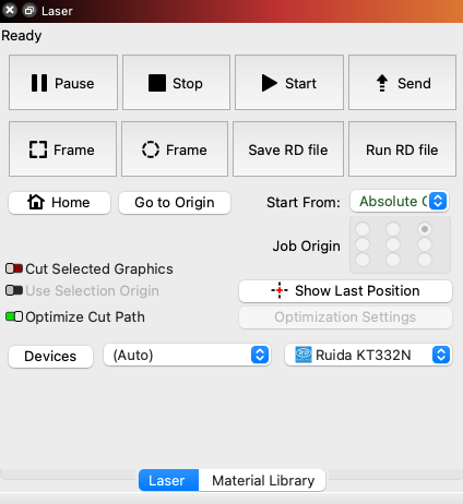

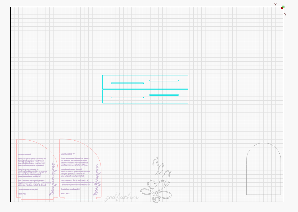

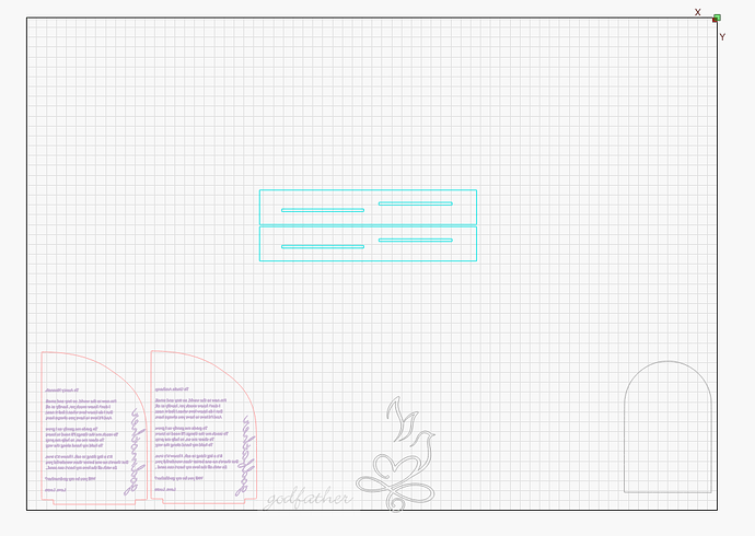

I have rest my laser and the origin is at the rear right. I have also switched to Start From: Absolute Coords and placed my design in the middle of the workspace. I am still having the issue of when I hit frame it only moves slightly or stops halfway through framing. I have included the below screenshots to assist:
Screenshots:
  • Preview
  • Laser
  • Cuts/ Layer
  • Entire workspace with what I am cutting placed in the middle.
i have videos but i am unable to upload them

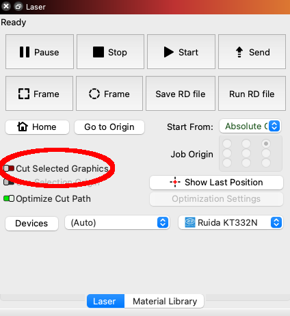

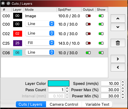

The LightBurn workspace shows some patterns extending beyond the lower edge:
That will cause problems when Cut Selected Graphics is turned Off, as it is in your screenshot:

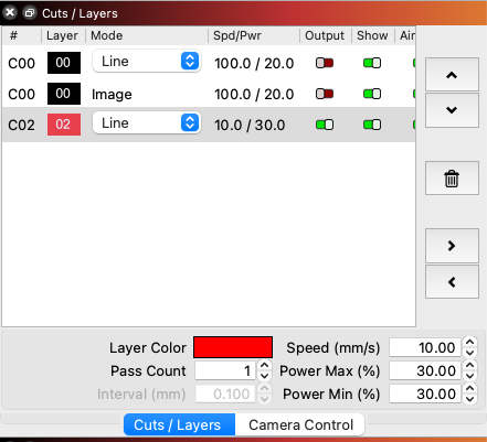

The Cuts / Layers window shows the layers for those off-workspace patterns are turned Off and they do not show up in the Preview. However, did you send the job to the laser immediately after you closed the Preview window?
That setup makes it very easy to inadvertently send unwanted things to the laser, so try this test:
  • Turn Cut Selected Graphics On
  • Select only those squares
  • Verify the Preview appears correct
  • Close the Preview
  • Hit Start to run that selection
How does that behave?
The speeds & powers appearing in the Cuts / Layers window seem excessive for a CO₂ laser marking cardboard; my 60 W machine makes a serious mark with 20% power at 300 mm/s. Upload a picture of the result of that test so we can look over your shoulder.
