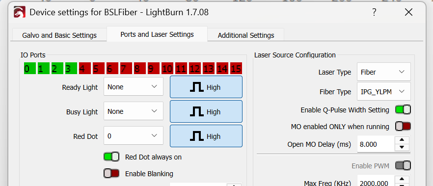

Just received a Monport GM 60W MOPA. The red frame does not function when using Lightburn Ver 1.7.08 or the pre-release version.
It does function properly when using the provided software from Monport (BslAppSimple). But I prefer Lightburn as this is what I use on my other lasers.

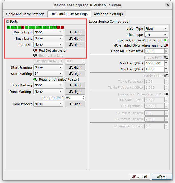

Might have to tweak your device settings… This is the only place I that directly affects the framing led. Some devices may have it wired up differently.
Maybe @Albroswift has some kind of suggestion. If it works with the supplied software, it must need to be enabled in the Lightburn Software.

Thank you very much!! You were spot on, I had to change the Red Dot Value to 0
Never seen Red Dot = 0 before. Thanks for reporting back. :smiling_face_with_sunglasses:
