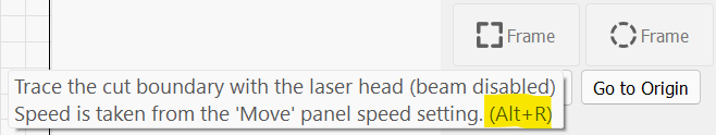

When i press the frame button with my mouse, and I’m holding the shift key the laser turns on and shows the place where the photo comes.
This is great. Only my laptop is not next to my laser setup! When i pressed the button and walk to my laser its half way finished with the framing.
My idea was adding a Usb Button on my enclosure.
And program it. Only problem is , its a mouseclick on a button en key hold down. I dont think i can program that.
Is there a key shortcut for frame with laser on?
Greetings from the Netherlands
Wim
Try this:
  1. Enable laser while framing in Edit->Device Settings
  2. Start framing operation with Alt-R for square frame or Alt-Shift-R for rubberband frame

It works when pressed Alt+Shift+R.
Yes…:sunglasses:
The option Alt+R don’t work ?
