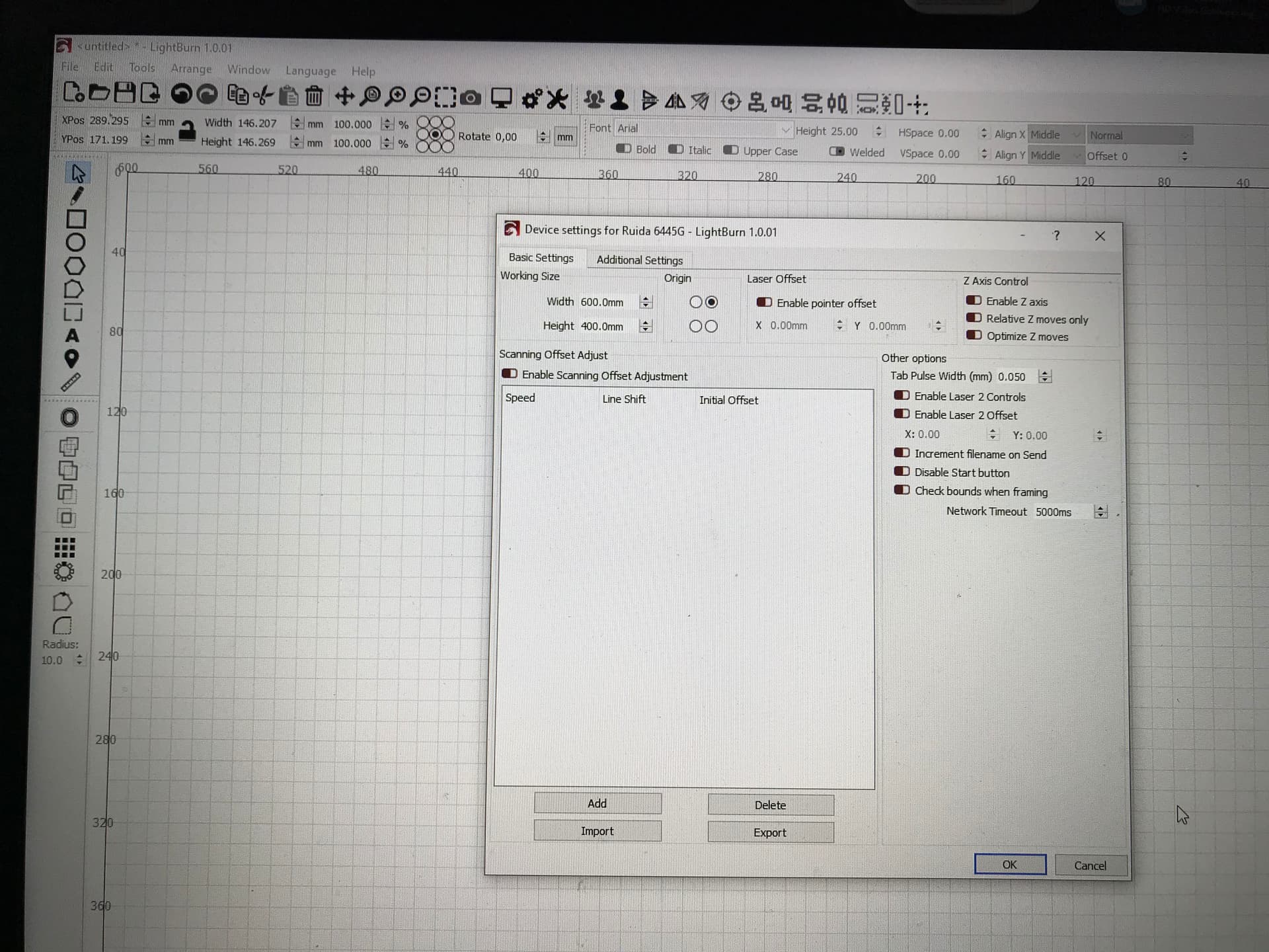

I made photo from device settings in lightburn. See attachement.
Thanks for the messages, the problem is solved. I am new in this Laserworld and have my first lasermachine, so no everything is clear yet, but probably the rotationmodule was activated, that was why he was cutting in one line. Now I deactivated this in Lightburn at preferences machine, the problem is solved! Just made a nice cut… really happy with.
