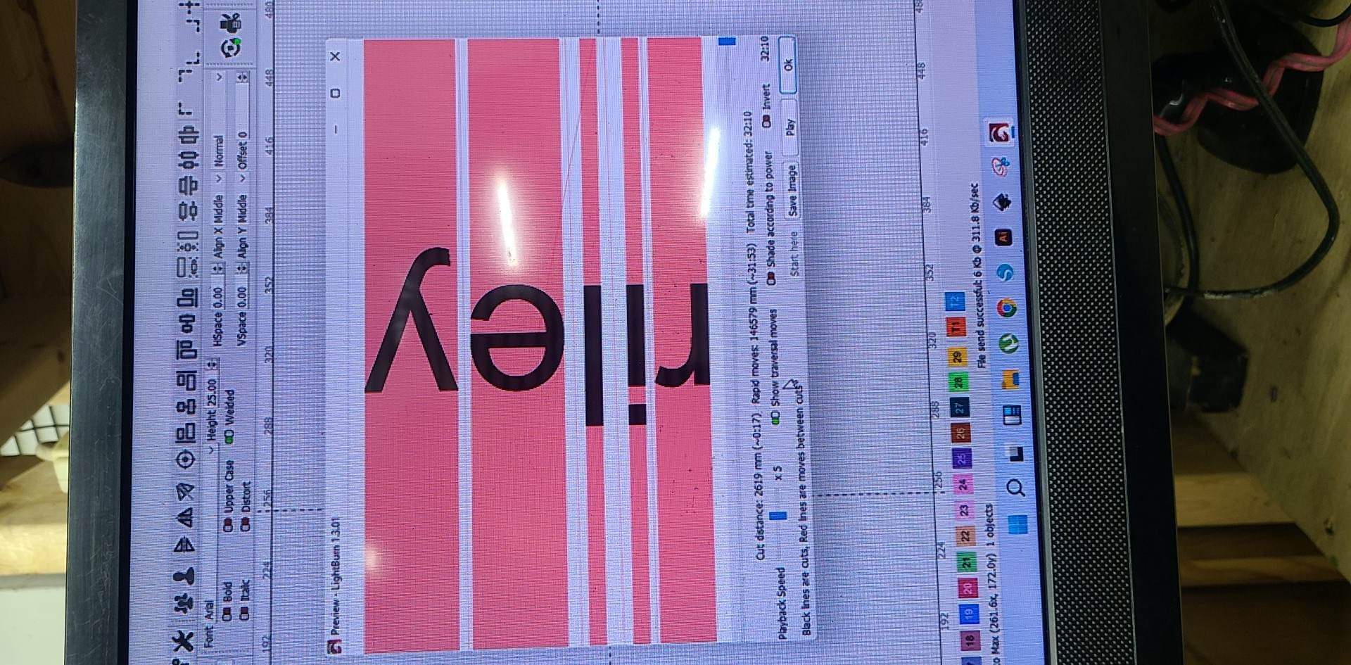

So I’m having an issue with lightburn and my ruida controller while trying to use rotary. Everything works in rdworks so I know my controller is fine. I have a very small image that I’m using testing purposed. It’s text. So I am using user coords and when I frame the item it works perfect. When I hit start the x axis travel is way beyond my image. If I turn the fill speed down then the travel shortens. The higher the speed the more exaggerated the travel distance is. It’s confusing to me because I’m adjusting speed and the speed doesn’t change but it’s causing travel distance across my x axis to change. But once again like I said it frames perfectly. Can someome please help me with this issue please?

Hey, I installed it all and it was so simple I busted out a laser job on a cup in no time. Then I changed the cup diameter for
rotary and it’s going crazy now. Between therr I had deleted the drivers for lightburn to open ezcad but I had reinstalled them as well and rebooted pc. I will attach picture of the travel path. Something is messed up somehow… I installed lightburn on my work computer and the travel path looks much tighter and close to the text. But what you see in the picture is actually what the laser is trying to do.
