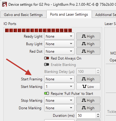

Are you referring to the IO Ports section here?
If you import the SeaCad config file when you added the laser to LightBurn, it should already set the ports correctly.
These pins are only used to start the framing with the pedal input of your controller. Framing should still work when you click the “Frame” button in the Laser window. Can you confirm this?

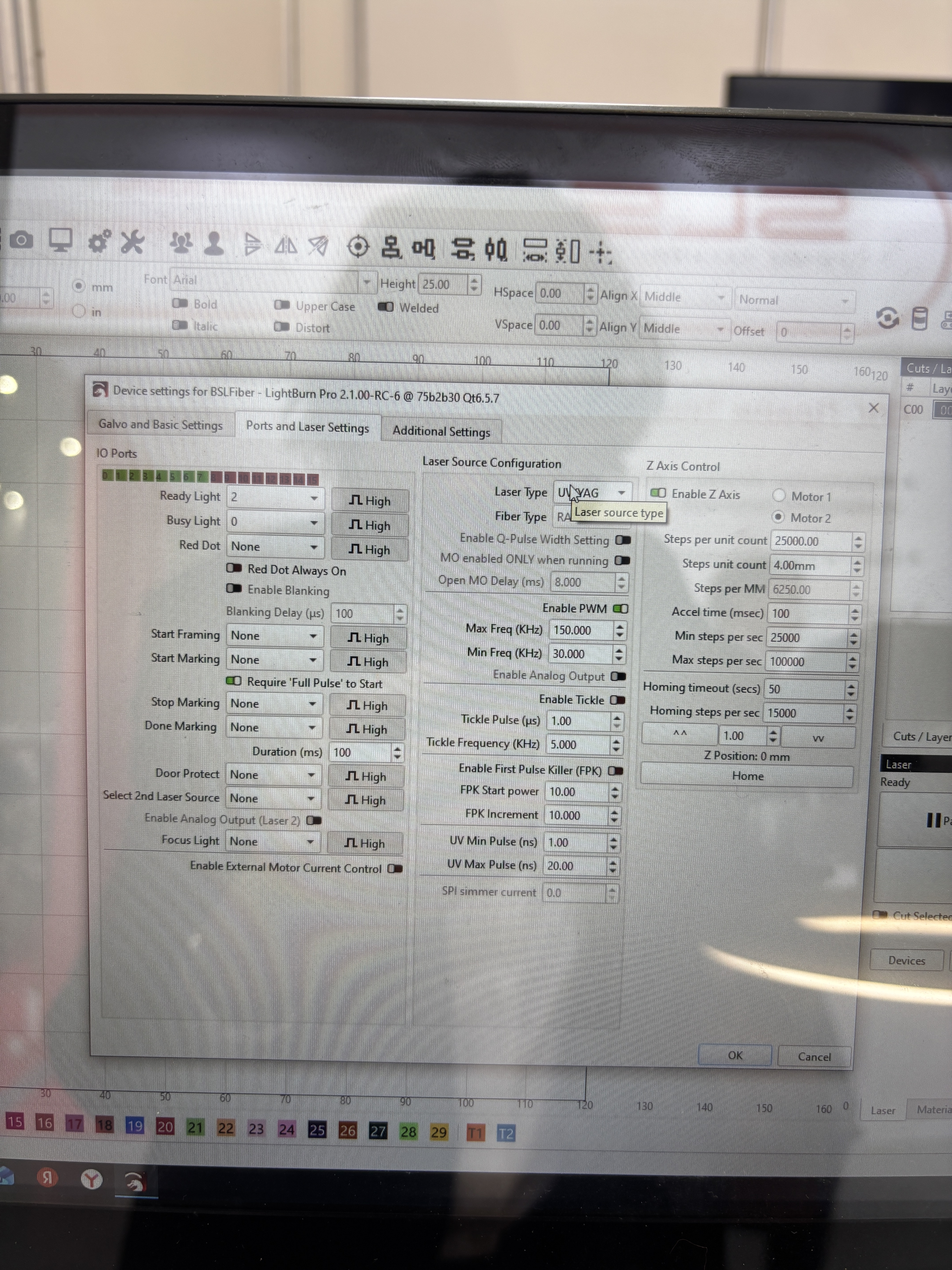

Can you send us a screenshot of the “Ports and Laser Settings” and the config file you imported?

As mentioned: The “Start Framing” pin is only used to start the framing with the external switch.
Clicking the “Frame” button in the Laser window should still start the framing. Can you hear the galvo mirrors move when trying to frame something?

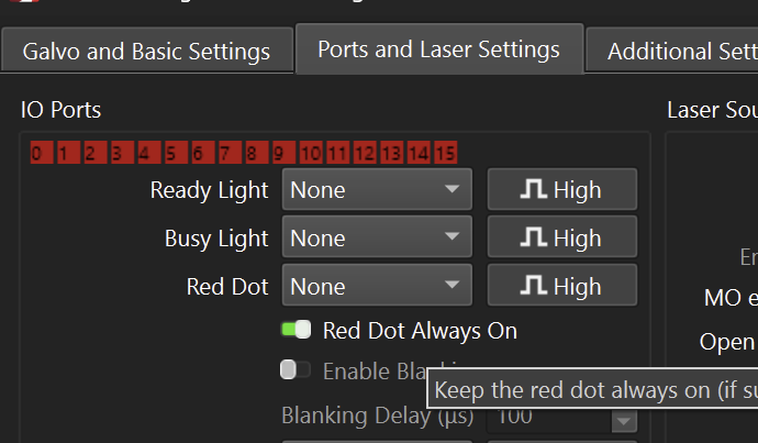

You might just be missing the Red Dot. Not every UV source has this. Some can only frame with the UV laser, which is invisible to the eyes.
Try enabling this setting “Red Dot Always On”
Settings for you
The port for “Red Dot” is set to None, so LightBurn can’t turn it on.
We still don’t know which laser you are using or whether it even has a separate Red pointer laser.

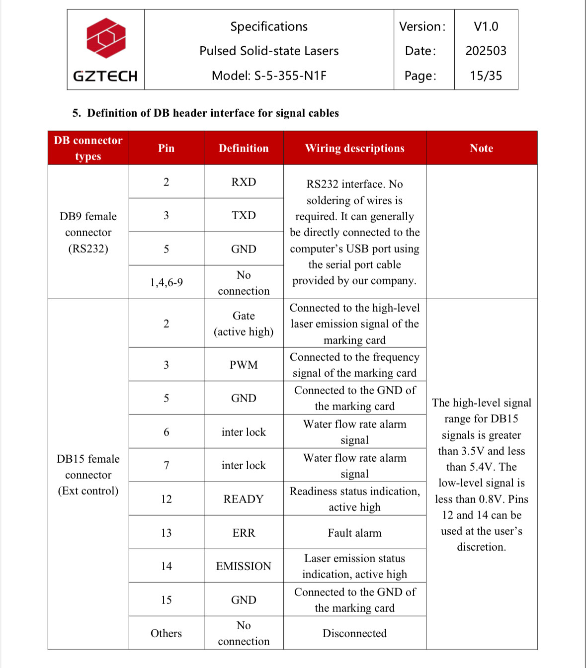

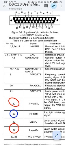

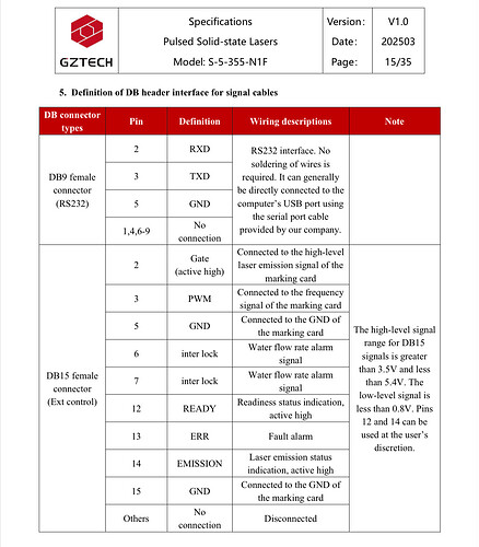

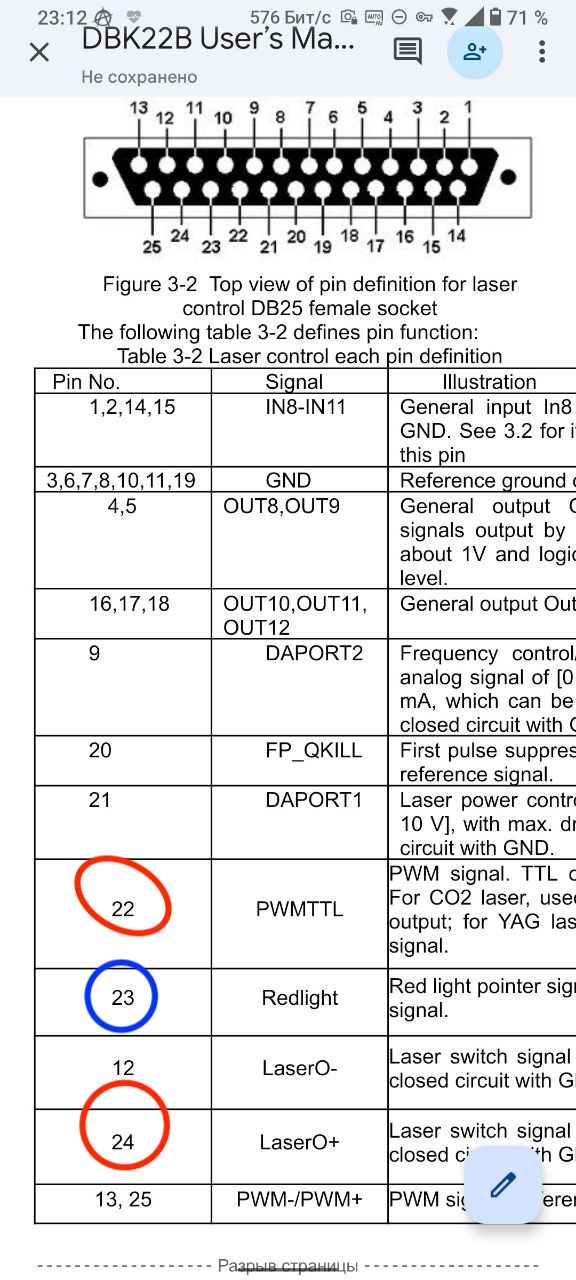

We use the following pins on the controller: pin 22 for PWM, pin 24 for laser activation (should be 0 when the frame is displayed), and pin 23, which is used in the controller as an alternative pin for the red pointer (we don’t have one). In Lightburn, when the frame is displayed, pin 24 is active (1) and pin 23 is also active (1), so the frame is not displayed. In BSL Seacad, pin 24 on the frame is inactive (0) and pin 23 is also active (0), but pin 23 can be set to (1) in the BSL settings. I can send video to you.

We still don’t know which exact laser you are using. This information is important for us to be able to help you.
Again, please review my previous messages and try to answer every question.
Also, please provide the information we asked for.
  • Screenshots of the (port) settings in SeaCAD
  • the .cfg file you imported into LightBurn

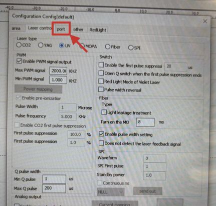

We need the info from this tab, please:
Can you confirm that you’ve tried this, please?

I tried to check “red dot always on” and still nothing happened. About corfiles. Yes, cor work only in BSLcad. In lightburn cor files correctly work only with jcz board and ofcource jcz cor files. Thank you

Please show us a screenshot of the “Port” tab in the SeaCad settings as requested.

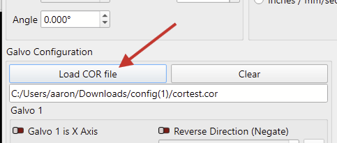

If I’m not mistaken, the “cortest.cor” file in the config.zip you uploaded contains the “raw measurements” rather than the hardware lookup table that’s being used by the machine. LightBurn would need to convert these measurements first, which it can’t presently do.
The file can be loaded in the Device Settings, but a warning should probably be displayed if an incompatible .COR file is loaded!

BSL’s COR files should work no matter what, because they produce the files, and we simply pass the files to their SDK for use. If the COR files you produced with SeaCAD or their tools don’t work in LightBurn, I can double check to make sure we’re passing the filename along correctly, but beyond that we don’t do anything with those files.
Also, worth asking - Have you run a job with the COR file set, or are you only looking at the red-light when framing? We had an issue in the past where BSL framing moves weren’t being corrected, but the running job was corrected.
For the red-light pointer issue, BSL has a function that we call to set the laser type, and when calling that function we also tell it if we want it to enable the red light. They have a separate function to “enable laser control” which to me sounds like “should the laser be controllable” not “should the laser be on”. Their docs and samples aren’t always clear - I’ll make a change and get you something to try.

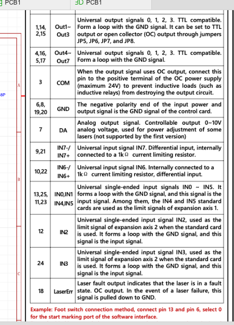

I also noticed some pin inoperability and signal inversions. For example pin 18 in lightburn pulled down to gnd in alltime. This pin needed only for engineers who produce marking machine, but i just report to you about this.
