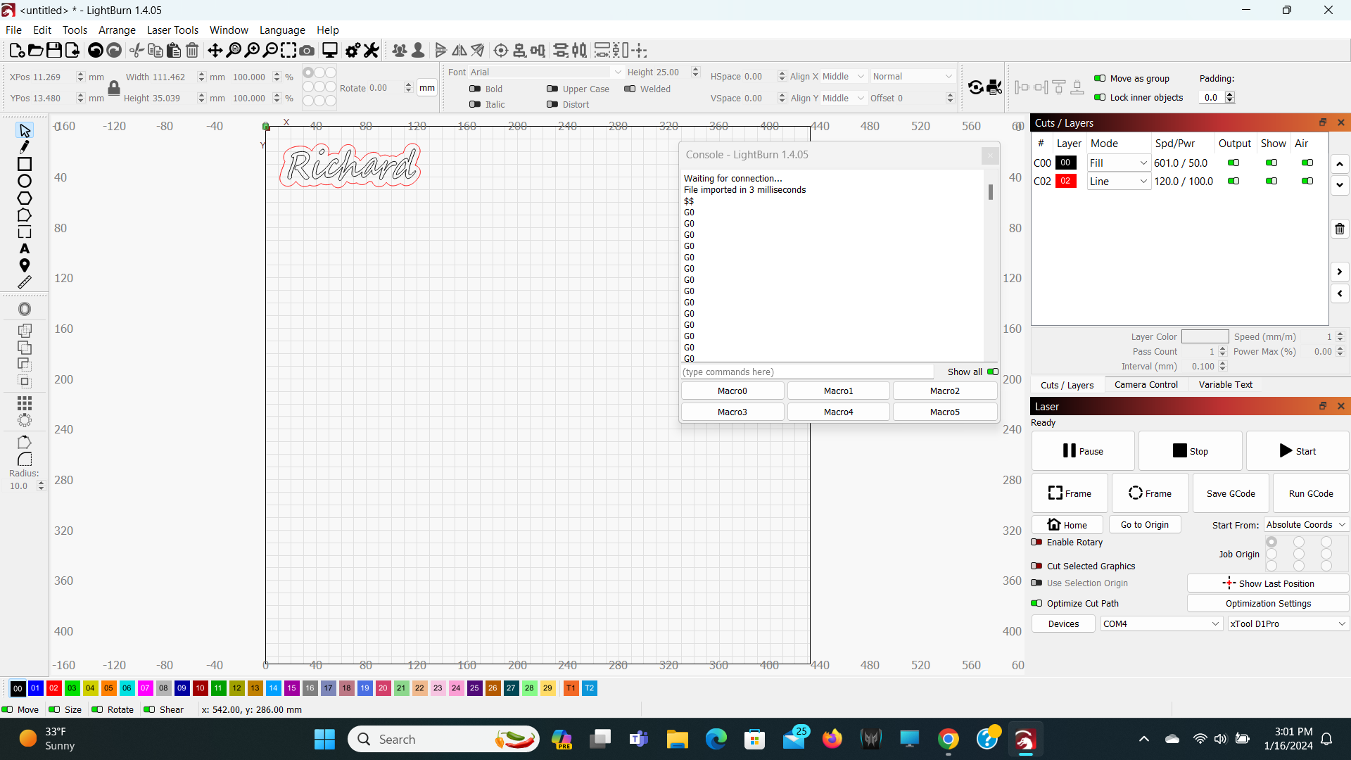

Framing Issue using X Tool D1 Pro
…extremely new at this laser stuff…after creating a project I followed in the Light Burn Software Manual I click on frame and laser would not move…depressed “Start” and received a message, “there was a problem sending data to the laser. The devise may be busy or paused.” …it shows that the laser is “ready” in the laser window
Type $$ in console then enter and paste results.
Along with screenshot of laser window.
Turn off show all in right corner of consol and input $$ and enter then copy/paste to here.
…thank you for your time, but tried diff things and finally figured out had the device connected to the wrong COM port
