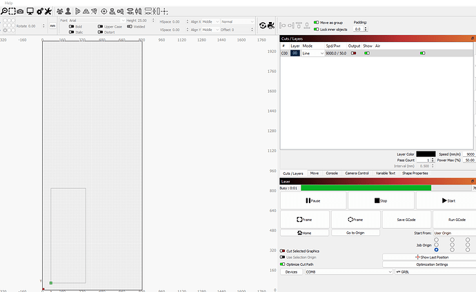

My Tyvok Spider X1S is not responding to the Framing function.
Windows 11, Lenovo Ideabook.What do I have wrong on my settings.
You have to tell us more about what is happening, post a screenshot (Win key +Shift +S) of Edit > Device settings and your project.
Just running it on a rectangle as a precursor to check if it will plot out for a project Im going to burn. Trying to feel out the parameters for my Tyvok Spider X1S larger format Laser 800mm x 2000mm.
I should add that it stops streaming at 76%

That said, this is a common symptom of a communications issue. Replace the dirt cheap USB cable with one that is foil shielded and has ferrite noise suppressors. And do not go much over 10 feet.
