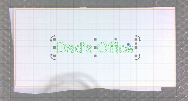

Here’s a brand new project I made and tried again to frame ONLY the center text, and it framed the outer outline that I made around the material.
You can see I have only “Dad’s Office” in green selected. But it framed along the larger orange shape.

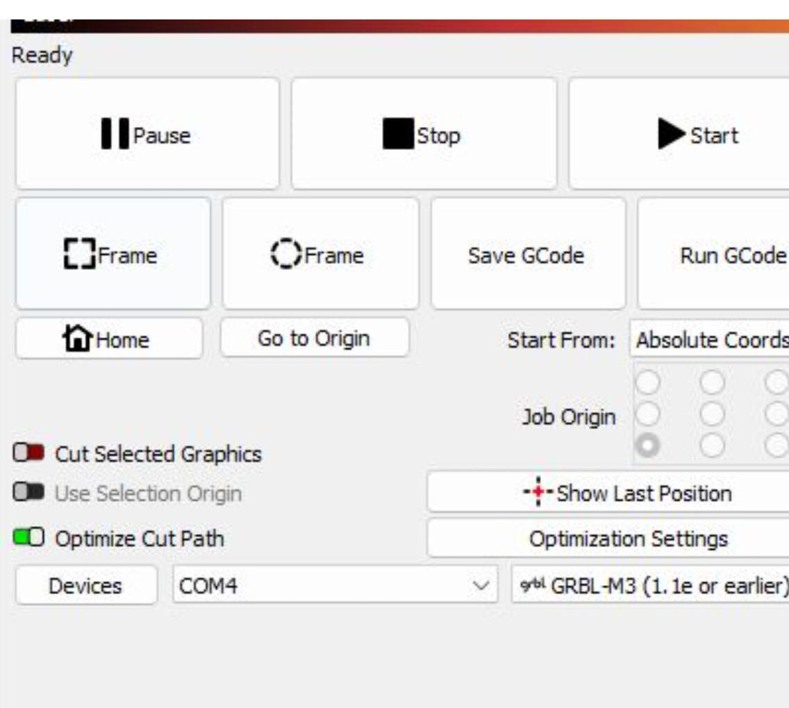

You have to toggle on Cut Selected Graphics
Does yours look like this?
Guys, thanks so much for all of the feedback and ideas. I figured it out, resolving the issue. All I had to do was to select/enable the ‘Cut Selected Graphics’ option in the Laser settings section. This now enabled the ‘Frame’ button to frame ONLY the selected graphics instead of the entirety of the objects in the work space. Thanks!
