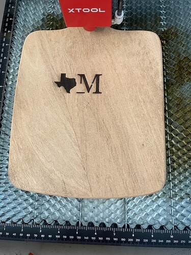

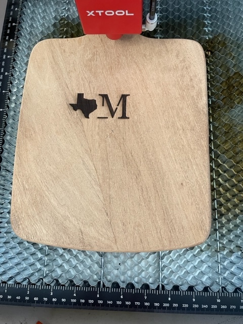

I framed my project completely in the center but when I started the burn, it was off-center. In the picture, it was supposed to spell HOME. It appears to just be off on the x-axis. The y-axis looks centered.
I’m using a xtool D1 Pro 20w. Using the blue laser light for framing and it’s set to current position. I have limit switches and auto-homing enabled on start-up and I’m using the move buttons to move the laser.
If you are using the blue laser for alignment then disable the pointer offset in Edit->Device Settings.
