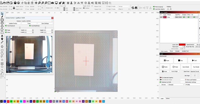

Hi - I have a Sculpfun S9 Laser which has been upgraded with limit switches, Sculpfun s500 Camera and 10w Laser cutter, I am using Lightburn (firmware for the machine is GBRL) and I am having the following issues: The camera image is off centre to the bed when I have calibrated and aligned the camera to the centre of the print bed and when I try framing a cut that is utilising 90% of the print bed the laser head tries to go beyond the printers frame - hope that makes sense. Any advice would be appreciated

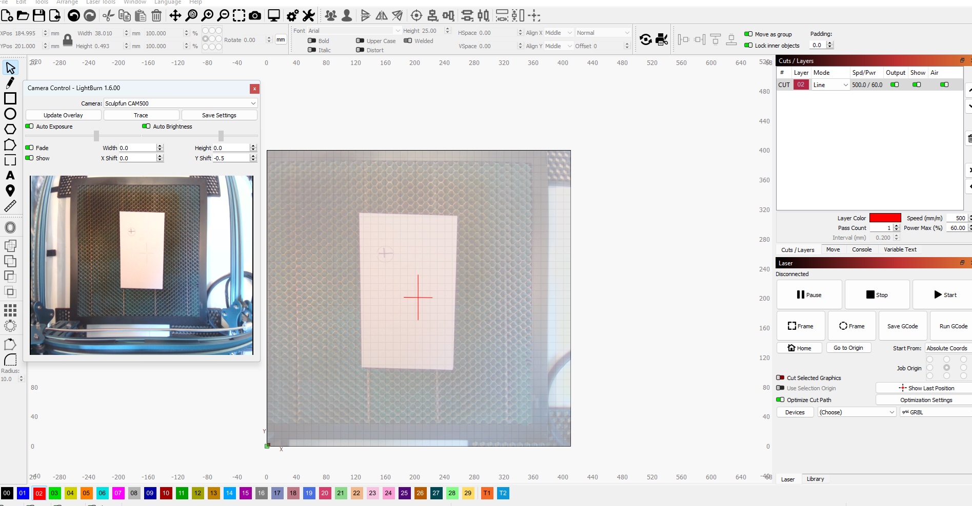

Here is the image of lightburn the image shows the camera centred on the cross which is in the centre of the print bed. As you can see the print bed is off centre and if I tried to print on the x axis at around the 400mm point the laser head would hit the right hand frame of the printer. The printer size is set to 410 wide and 400 height. So not sure its a camera issue but a calibration issue with Lightburn and the Laser printer
Which one? Both are not centered on the honeycomb, the small one is shifted to the top-left, the red one is shifted to the right.
Do not rely too much on the centering. It doesn’t matter where the camera is placed exactly. The alignment step will care about the position. Place the camera where you want it to be, do the alignment, and then you have a clear relation between camera and workspace. Of course, only at the specific height you did the alignment on.
It is the red cross that I am referring to, please ignore the smaller to the left, this was a test to see if I had aligned the camera correctly which I have. If I align to the centre of the print bed then tracing the image in Lightburn is way off.
I should also add that the red cross is centred to the middle of the Lightburn workspace, but it is way off when you look at the printer mesh (which is centred to the Laser)
As I said, do not pay too much attention at physical centers. First, the laser workspace is not centered in the frame of the mechanics. Due to the laser head size and the limit switches, the actual workspace of the laser is shifted to the rear right, compared to the aluminum bars of the laser frame. So don’t care about this.
After camera alignment, do an update of the overlay image. Then move the laser to the corner of the object you have in. Does it meet the corner? It doesn’t matter where it is displayed in the LB workspace, only the positioning between the image and the laser head is interesting. So if you for example, take the move laser function and move it to the small cross, does the laser head move there?
