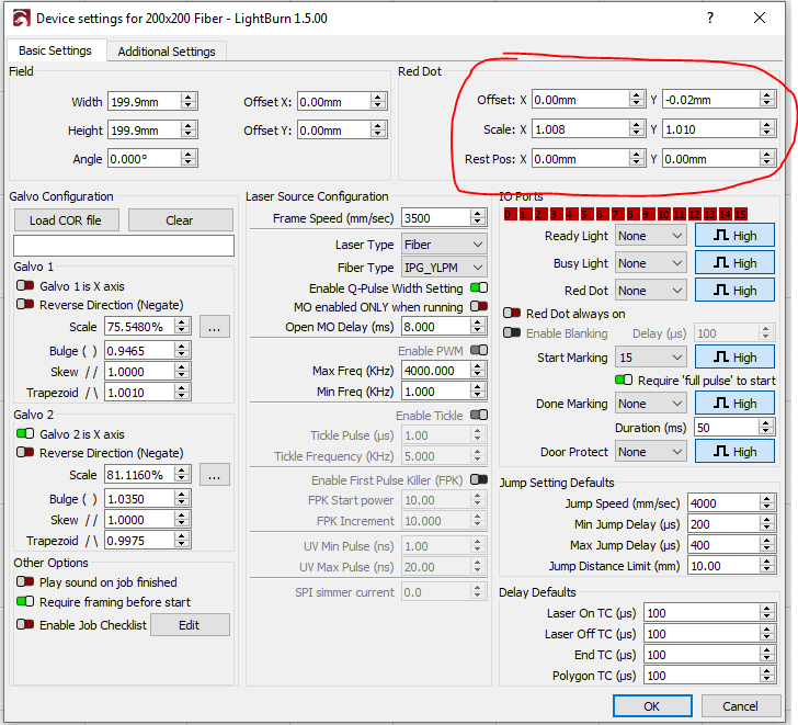

If you hit F3 in LightBurn, you can adjust the sizing, position, etc. of the Red Light for Framing in this area:

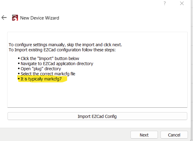

That might be a solution. When I installed LightBurn the file markcfg7 was never used or asked for. I am using version 1.4.05 and there should be a way of loading the Factory Calibration Settings manually. I did Double_Click the Device type and was asked for the config file, but it never stated the name of this file, so I guessed it was markcfg7. Then I got “Unable to locate specific COR file: E:\jczEZCAD for ComMarker B4\110mm\jcz11.cor. You will have to manually load your COR file in Device Settings”. I am going to need help with this task. I am still not sure why this is not automated in the Installation Manager.
Yes, the steps you went through are to load the markcfg7 file. It’s annotated at the bottom of that screen

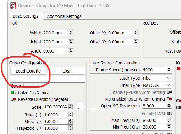

If you have a .cor file to load, that’s loaded in the F3 page here:
I have hundreds of files. Can you advise me of the file extension, this would help in locating the file. I do see a CorFile2.exe but I dont think the cile will be an executable.
Cor files produced by EZCad2 software has a .cor extension. The markcfg7 has no extension.
On my supplied EZCad2 memory stick they live here…
LMA22A1095JZ/Ezcad2.14.16/plug
These were supplied on my machine, only used markcfg7 file

Yes, I know this. I received files for both of my lenses matched to the Serial Number of my machine. The lager cut is now exactly square. The issue now is when I draw a square on the Job Area of LightBurn, it frames 116mm x 116mm and not the 100mm square I drew. I presses F3 and found on the top right some scaling parameters. When I changed the scale from 1.0 to 0.862 to see if this fixed the issue, but there was no change…any advice please.
