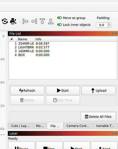

There is a file window, that has to be enabled… I’ve had to delete one file at a time when it got full… They do strange things when they have a limited memory…

I got into the file screen, and it says coms error and does not give me file list…
OK, how do i get there, I SWEAR i have looked, and most of the info i found, does not work on my controller…

I’d go for selecting each file and attempting to delete it… if it doesn’t work on one, move to the next file. If you can’t remove or delete them, you might have to reset the controller… but it’s probably worth some time to try and delete them and avoid a controller reset.
Have you also tried to delete them via the machine console?

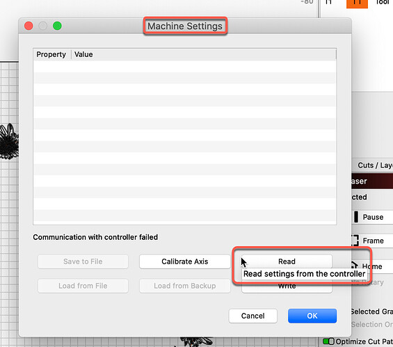

If it works or not, I’d suggest you get the pc to read the controller… that will allow you save the current configuration to a file and to reset the controller. You can then read the file and write it to the controller restoring all the vendor data.
It needs to connect…

Once connected, you can try to read the controller by using ‘Edit’ → ‘Machine Settings’.
Please update, do you still receive this “coms error”? If so, show us what this looks like.

I’ll try to delete some…
Probably have to use refresh…
If the file tab isn’t present, select it in the Window drop down.
HEY HEY, i am doing all of this on the laser, on the controller. Nothing in LB…

Where is this in LB?
Edit → Machine Settings

I answer below, but you have a bigger issue. Nothing you do on the computer side will address what you have identified with the controller hardware. Please let us know how that investigation progresses. :slight_smile:
