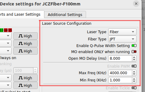

I have a Max 50W fiber laser with a 110 lens The mfg specs state Freq. 20-200khz.but LB will only let me go to 80khz. What am I missing?
What type of source do you have set in the device settings?

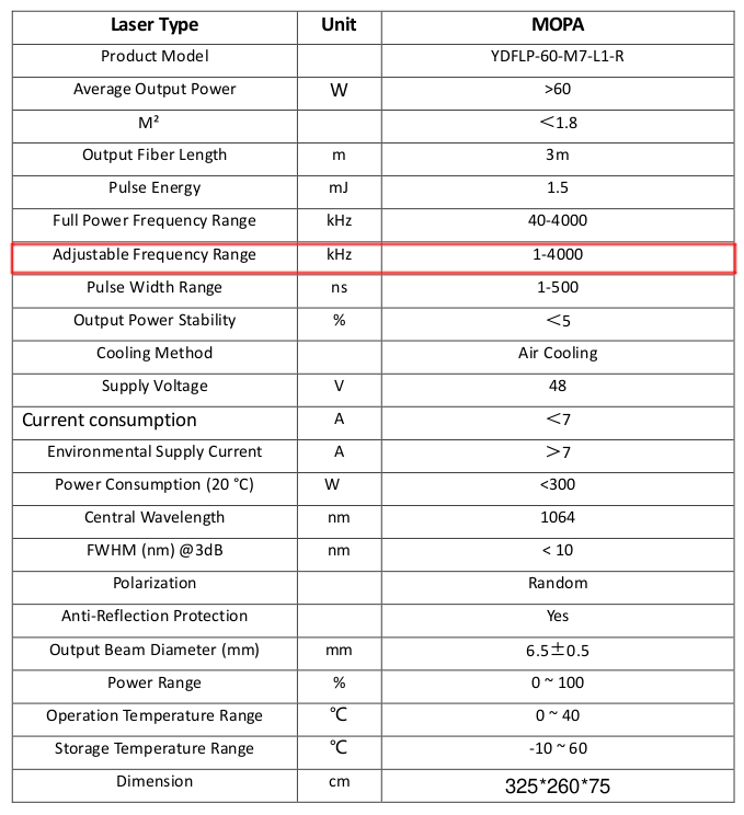

Is Max Freq 4MHZ (4000KHz) right?
From my fiber source manual.
Wow! You could almost send a radio signal with that thing. :joy:

Though the website does mention a Pulse Frequency Range of 20 - 200 kHz for the Max. You can change this in the Device Settings after you’ve added the device.

If everything else is working, and you’re sure the laser source goes up to 200kHz, you can change this in the Device Settings.

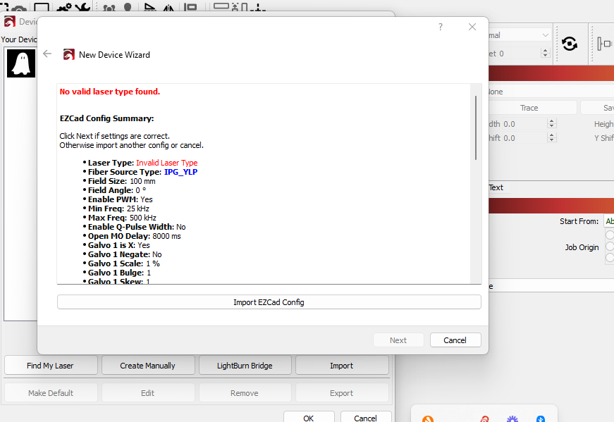

Ok, I found the markcfg7 file, but when I double click on it, it states ‘no laser type found’. But in the devices, it says it’s a JCZFiber.
When you create the device, it will query you for the EZCad configuration file. If you edit your file, it will, supposedly, update it without disturbing your other settings… at least the gui settings.
Good luck
I’ll try removing the laser and add it back in. Thanks.
I removed the laser and added it back in but when I double click the marfkcfg7 file I get this:
If you open the markcfg7 file in Notepad, what number do you see on the line LASERTYPE= ?
If you delete this line and save the file you can import it, and it will automatically select “Fiber” as the Laser Type.
The configuration file sets a max freq of 500 kHz, which is wrong according to the Ebay listing. You can correct this later in the Device Settings, but it might be worth asking the manufacturer if this is really the correct config file for your laser.
Seeing the default values of 1 on the Galvo Scale, Bulge and Skew, you will need to perform a Galvo Lens Calibration after this. Or load a .cor file if you received one.
