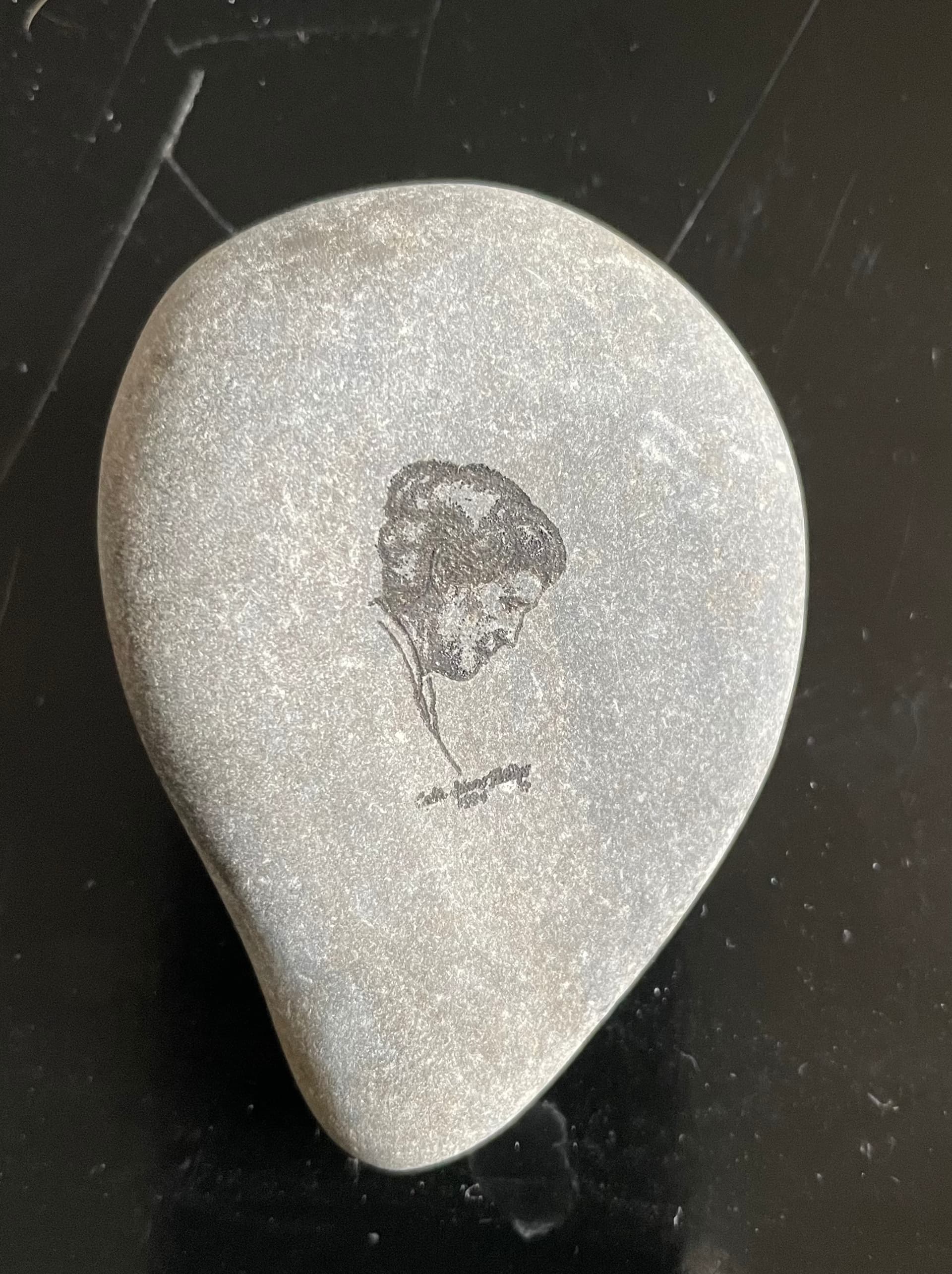

This is rock that showed practically nothing after engraving. Used some black powder coating to go over it again at a lower power setting and it came out very nice. Powder coating from Harbor Freight.

Gunpowder? Just kidding! Nice solution. This the $8 solution?
16 Oz. Powder Coat Paint - Matte Black
Yes it is. Just spread it on smoothly with the edge of a business card. With my 40W laser I go back over it at 10% power and 200mm. Brush off the excess. Works also great on wood engravings.
Also I use electricians putty to stabilize the rocks or any other small item. Doesn’t dry out and doesn’t leave any residue. You can find it a Lowes or Home Depot.

Really nice work by the way. Do you think that different colored powders would keep their color after lasering.
MikeyH’s rock with the larger white particles (the one on the right) didnt show the design as good as the grey stone but if the depression is there then the extra process of adding powder makes it worth the extra time. Also because its nice looking rock.

I have only tried the black but I am going to get some other colors. Harbor Freight only has Black & White. The laser just melts the paint into the engraving.
I turn air assist off when going over the powder at a low power setting but keep it on when etching the stone. If you can’t turn air assist off then it probably wouldn’t work.
Can’t with my 40w, but I can with my 2 10w machines. Unfortunately, the laser cooling fan cannot be turned off. I ran into this when tying TiO2 + alcohol on white tiles. Blew the powder right off the tiles. Maybe I can mix the power with a binder like a bit of white glue.

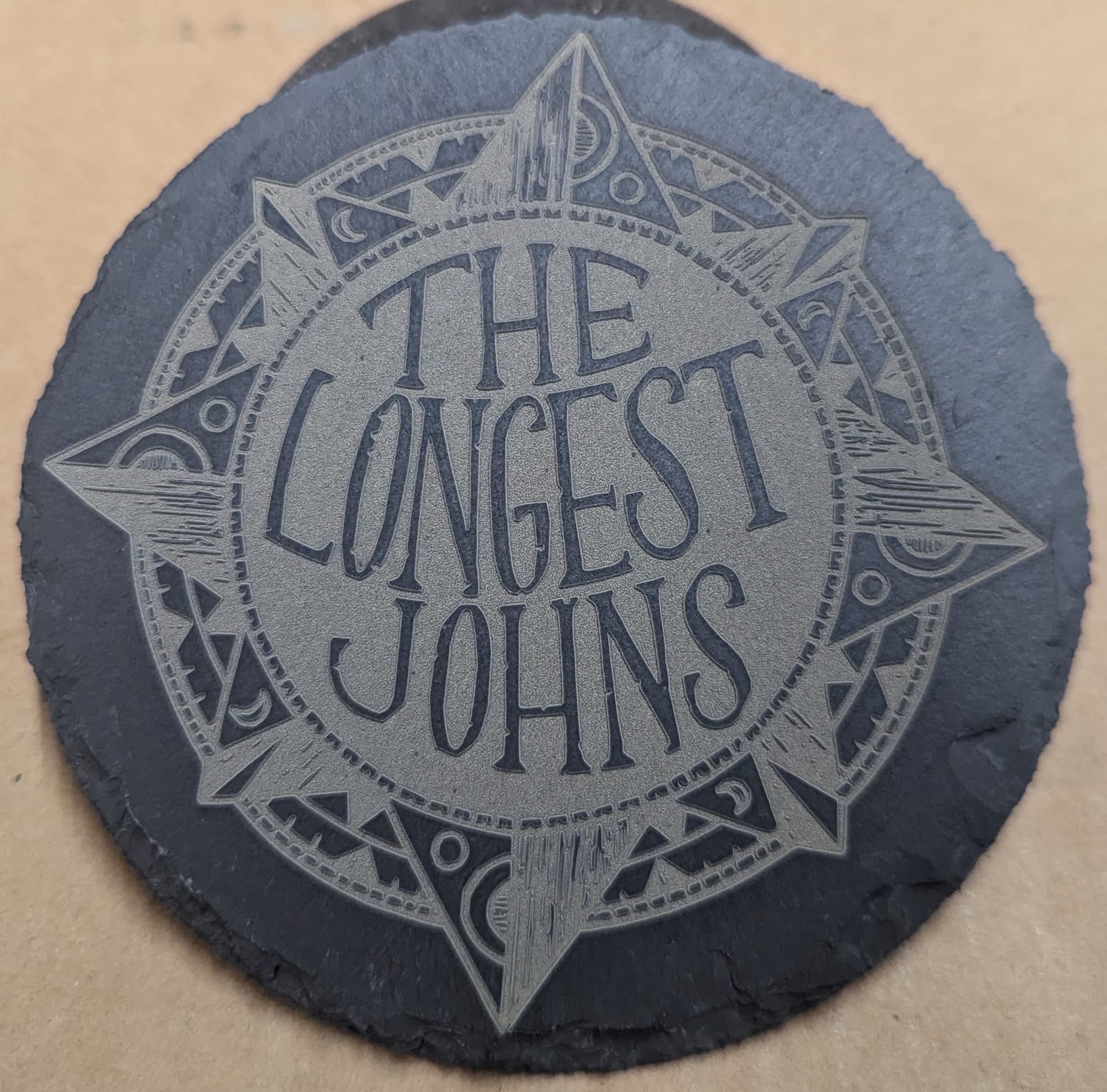

Okay, so they’re pre-cut rocks instead of random landscaping rocks, but I took what I’ve learned from the black rocks and tried it out on slate coasters. This was my 60W fiber laser again, and I did the two-part treatment again. The first part is engraving down into the surface (removing material to give it relief), and the second part goes back over the engraved area with settings to give kind of a micro-beaded/vitrified surface.
A standard etching turns the slate light, but that seems to be from the microtexture scattering light. When it gets wet, the water makes the surface much less scattering. The intention with the second part micro-melting the surface of the coasters is that the being tiny glassy bits should make it less affected by water, I think.
I’ll have to get around to looking at it under a cheap microscope, not to mention doing a proper A-B test. For now, at least, it looks nice, and I finished the set of coasters before the concert in Dallas on Saturday night.

Really nice texture & finish on the lower grey surface.
So do you remove the material down to depth where the spot becomes defocused and go again without adjustment to z to just apply heat, or is it a speed and power adjust for part 2.
