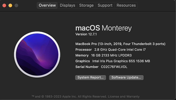

Can you post an About This mac picture
also, while connecting to your machine

Screenshot (hopefully) attached.
